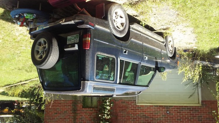

The Land Rover really isn't a piece of junk.  It was running when she parked it 2 or 3 years ago.  I actually looked at it last year, thinking about buying it but didn't have the time to fool with it.  Now she wants it out of her driveway and tossed it in with the Silvereado.  Here are a couple of pics of both vehicles...
