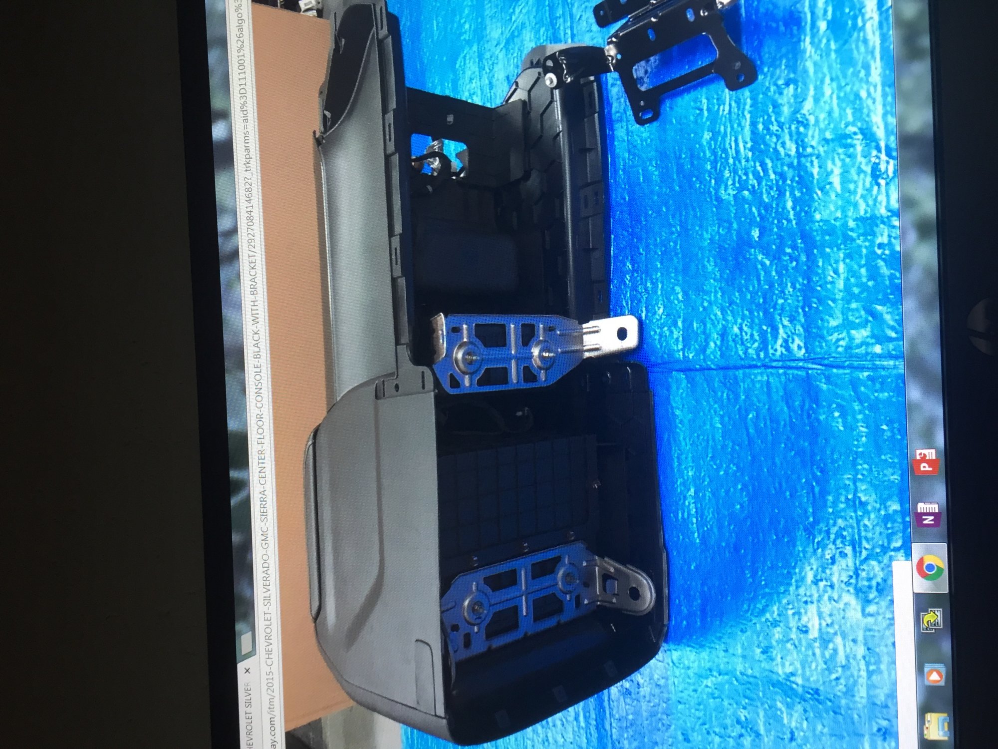

Kind of hard to see from this picture but it's the only one I've got. There is quite a bit of wasted space under the front of the full floor console. This is where the Bose subwoofer is placed when that system is installed. There is a guy on Ebay that sells sub enclosures to fit this space and you may be able to contact him and ask for the dimensions. Here's a link to one of his auctions:

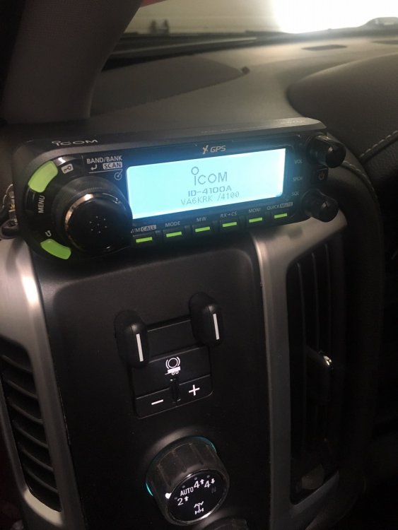

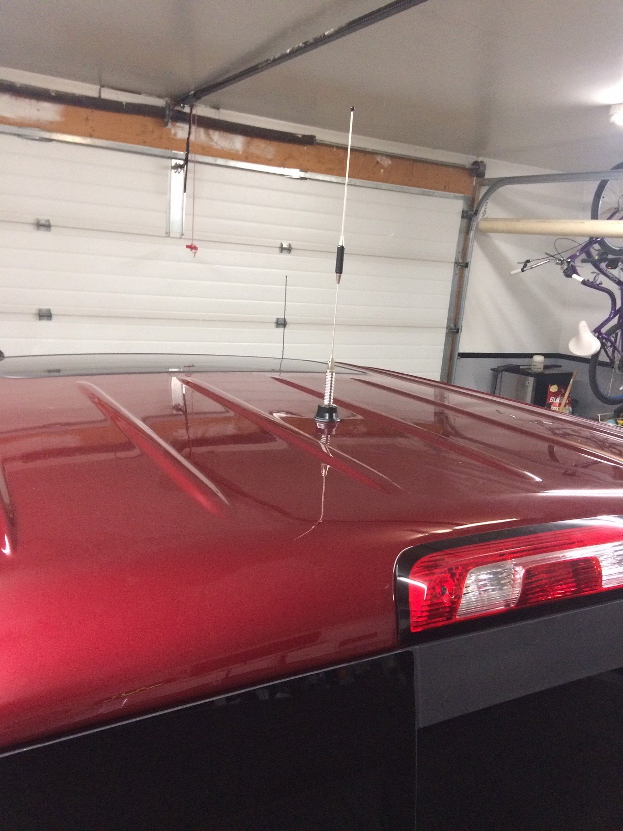

I have an Icom ID-4100 radio installed in my 2017 GMC. I also have the Bose stereo. I made a custom bracket to hold the head unit just above the vent on the left of the steering wheel. The main unit us under the rear seat back. When mounting the radio under there you need to be careful as the seat back lowers when the seat is down. I put an NMO style antenna in the roof and love it. I would highly recommend that antenna install.

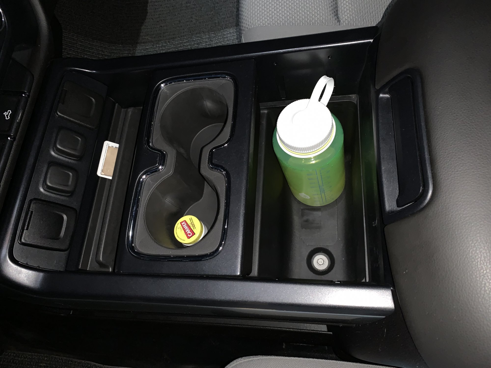

Here's the amount of space in the center of the floor console with the movable cup holder moved to the forward position. That's a 1 liter Nalgene bottle for scale. 2 of them will fit with room to spare. You would have no problem putting a CB in this space, and there is plenty of room under the front of the console for a head unit or amp.
