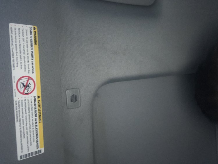

Philip Gilmore Posted November 14, 2018 Author Share Posted November 14, 2018 Damage from the first time it leaked Quote Link to comment Share on other sites More sharing options...

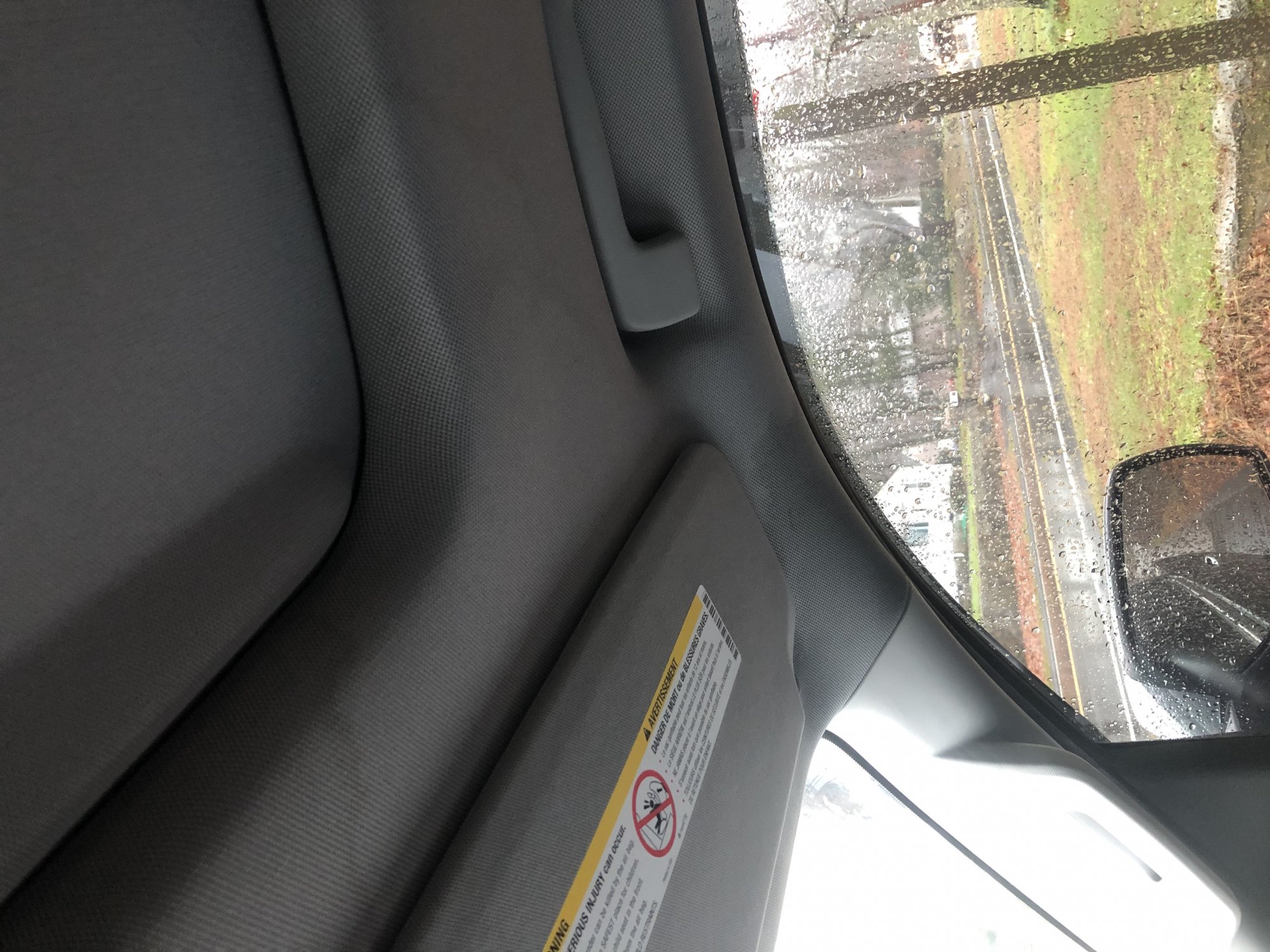

2017Darkness Posted November 14, 2018 Share Posted November 14, 2018 Did they say anything about the drains? I see trees in your picture...GM sunroof drains are notorious for collecting sh*t...Just wondering if they cleaned them, seals aren't usually the problem. 1 Quote Link to comment Share on other sites More sharing options...
Philip Gilmore Posted November 15, 2018 Author Share Posted November 15, 2018 4 hours ago, 2017Darkness said: Did they say anything about the drains? I see trees in your picture...GM sunroof drains are notorious for collecting sh*t...Just wondering if they cleaned them, seals aren't usually the problem. I checked them and the dealer checked them. The sunroof hasnt been opened since the repair. Quote Link to comment Share on other sites More sharing options...
