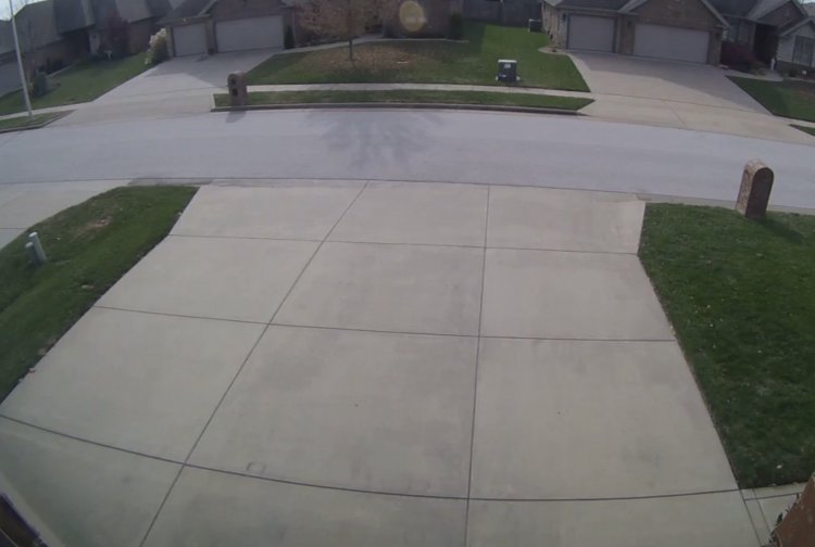

I have narrowed it down to lines that are  perpendicular from the car... like moving backwards towards concrete sections in the driveway sets it off.  I backed up down a whole street that was blacktop and didn’t get a peep from the sensors, but I back up my driveway that has concrete and has the sectioned areas (kind of hard to explain) and it sets it off every time.  Happens in both my driveway and my parents. We both and concrete sections on our driveway and the truck rear sensors give a warning and the seat vibrates every time.
There we go.  See the driveway sections.  The horizontal ones like to freak out the sensors for some reason.
Those kinds of lines / breaks in the driveway freak out my '18 Yukon Denali as well.
Contraction/Expansion Joints :thumbs:
Bingo! Thanks for clarifying!
