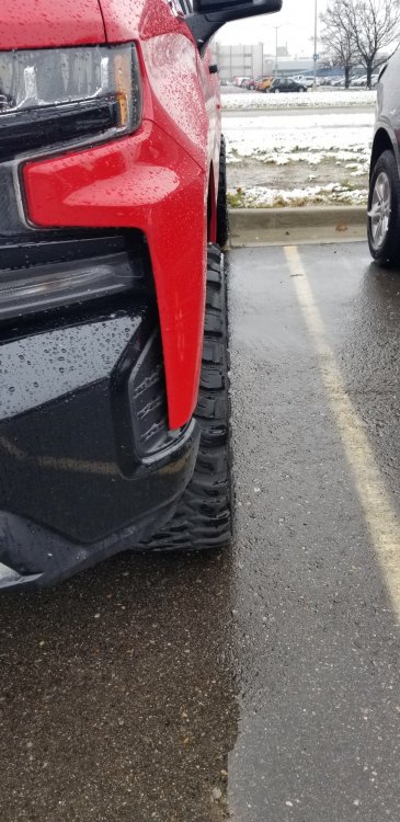

The 275/65R20 will fit but the 295/65R20 will not since it measures out to a 35 inch tire.  You either need a level or the stock rims for a 35.  They do make 295/60R20 which measures out to 34x11.7 and that may fit.  I'm running 305/55R20(33.5x12.5) on a 0 mm offset and it does rub slightly
Thank you any idea how far out the 275/65 will stick out on the contra with a +1 off set and 5 back spacing?
Honestly, it will probably be flush or barely sticking out with the fender.  My 12.5 wide tire is sticking out about 1 inch and that tire is only 11 wide so .75 inch less wide on each side.  Do u want absolutely no rub or are you trying to run a wider tire and dont mind a very slight rub like me cuz it is the slightest rub and only at full lock.
