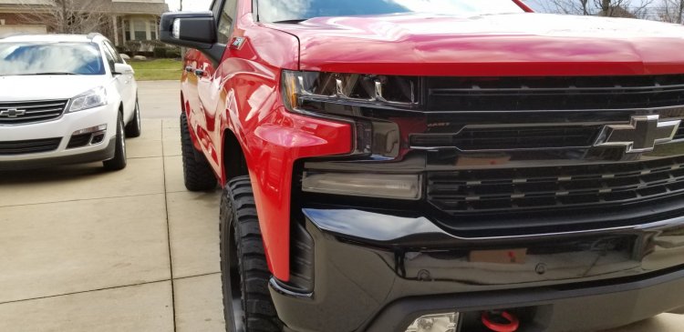

8 minutes ago, z1boss said:
Honestly, it will probably be flush or barely sticking out with the fender.  My 12.5 wide tire is sticking out about 1 inch and that tire is only 11 wide so .75 inch less wide on each side.  Do u want absolutely no rub or are you trying to run a wider tire and dont mind a very slight rub like me cuz it is the slightest rub and only at full lock.
I want something that will look good with fender flares
Lol then its gonna rub in order to stick out that much, unless you level it.  They do make a 285/60 and 295/60 which may or may not rub.  They also make a 305/55 like mine in the Ridge Grappler that is 12.44 wide and should stick out close to mine.  From an angle(see below pic) mine look like they stick out a lot more than they do from directly from the front so that size would look good with the fender flares.  Up to you, but like I said my rubbing is very minimal and it doesn't bother me personally at all.
Edited by z1boss
Is there a good leveling kit for the trail boss
There is no official kit yet for the Trail Boss but some have used the Motofab 1.5 inch level with no issues so far.  Angles look okay from the pictures they have posted.

Just put Nitto Grappler G2s on my 2019 Sierra SLT this weekend 285/65/20 on factory rims to replace the original 275/60/20.  Really fills up wheelwell better as it is 1.6 inch more in diameter.  Really like my stance now with the GM Accessories lift (aka Trailboss/AT4 Lift) and Rough Country 2 inch leveling lift.
One more picture
center front fender edge 40  1/2 inch
rear 41 3/8 inch
