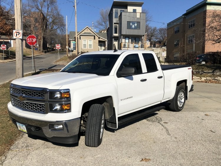

Hi Guys,
I'm not a huge motor head, but I change my own oil and like trying to troubleshoot/fix things on my own before going to shop-hard to do with all the computers at times.  I recently purchased a 2014 Silverado DoubleCab with the 5.3 in it.  Previous owner was a guy running a territory and was looked over every 7,500 miles/things replaced when they needed to be.  It currently has 193k miles and I was curious on some things I could be doing as preventative maintenance to keep this truck running clean for a while.
Couple things I have in mind are plugs and tranny flush (know there are plenty more to do) but I'm not super sure on mileage of when they are supposed to take place.  Let me know what you guys have done with your experience...  Thanks!
