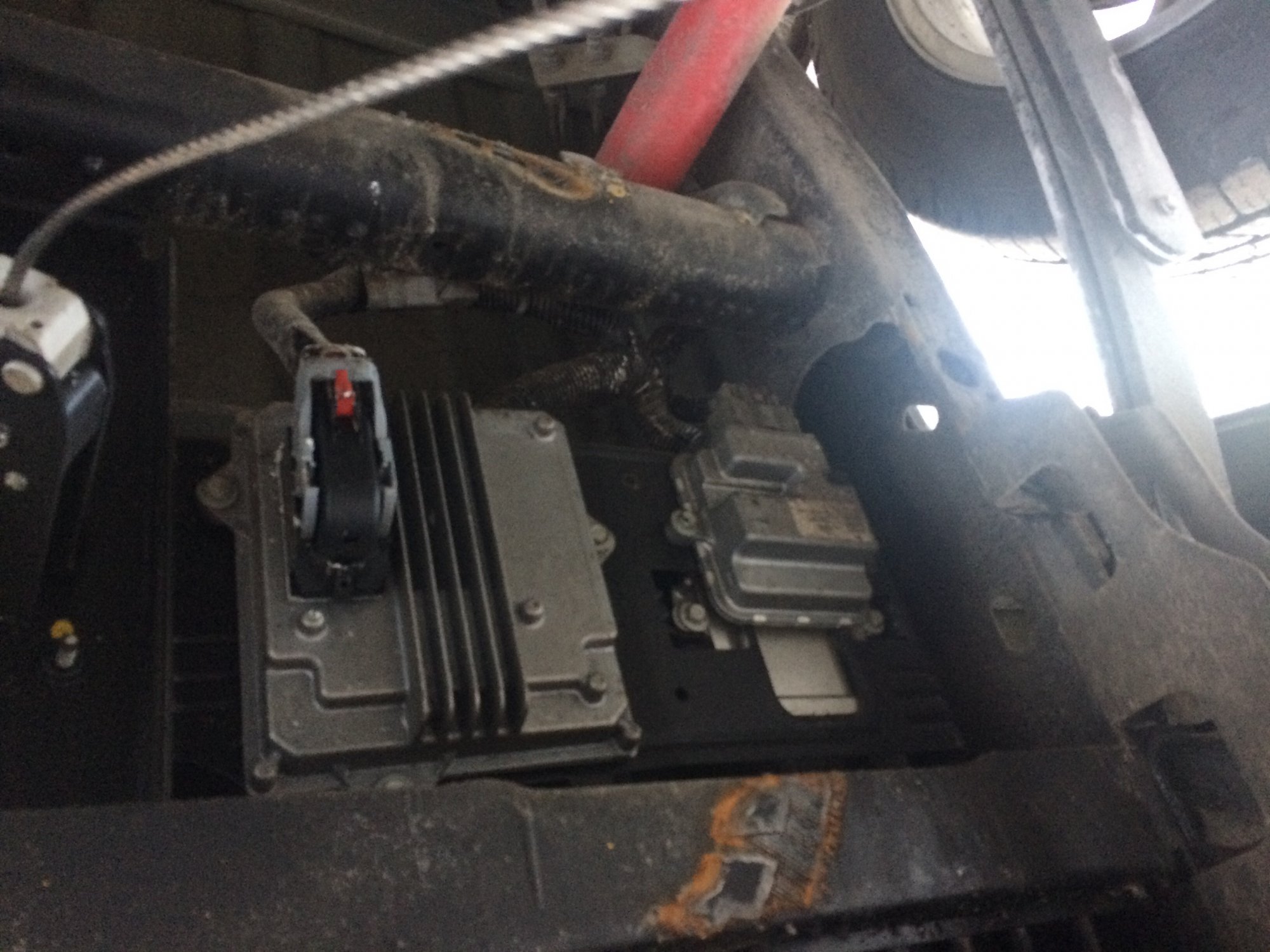

These things? I have another thread going where I asked what they were and a guy did say trailer controller. I had no idea
That small box is the trailer brake relay.. the other is is the TBCM.

I saw one video where the guy disconnected it, cleaned the clips and such and used electric grease in there and put it all back. Try that. Moisture may be the cause.

perfect, as soon as all of this holiday stuff is over I can climb under there and try to figure this out. ALL of yoose guys have been a big help thanks!
