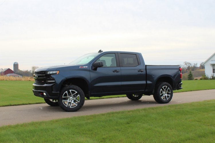

On 4/11/2019 at 7:53 PM, CPBassGuide said:
I put my new wheels/tires on today. 20x10 -18 Fuel Vandals w/ 33x12.50 Nitto Ridge Grapplers. The wheels slightly brushed the front brake calipers, so I had to add 1/4” spacers. So now, it’s at about a -24 mm offset. There’s only a slight rub at full lock on the back of the wheel well. It’s a Trail Boss with the 2” stock lift. I’ve also added a 1.5” MotoFab under strut leveling kit.

Looks great, have you done the bracket mod?  That will resolve your rubbing at full lock.  Remove the mudflap, there is a small bracket that provides support for it, remove that and re-Install mudflap, this will push mud flap back enough and should eliminate the rub.
