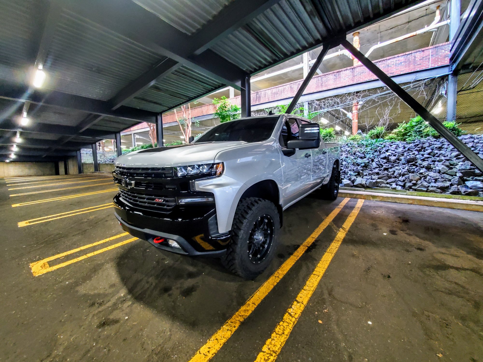

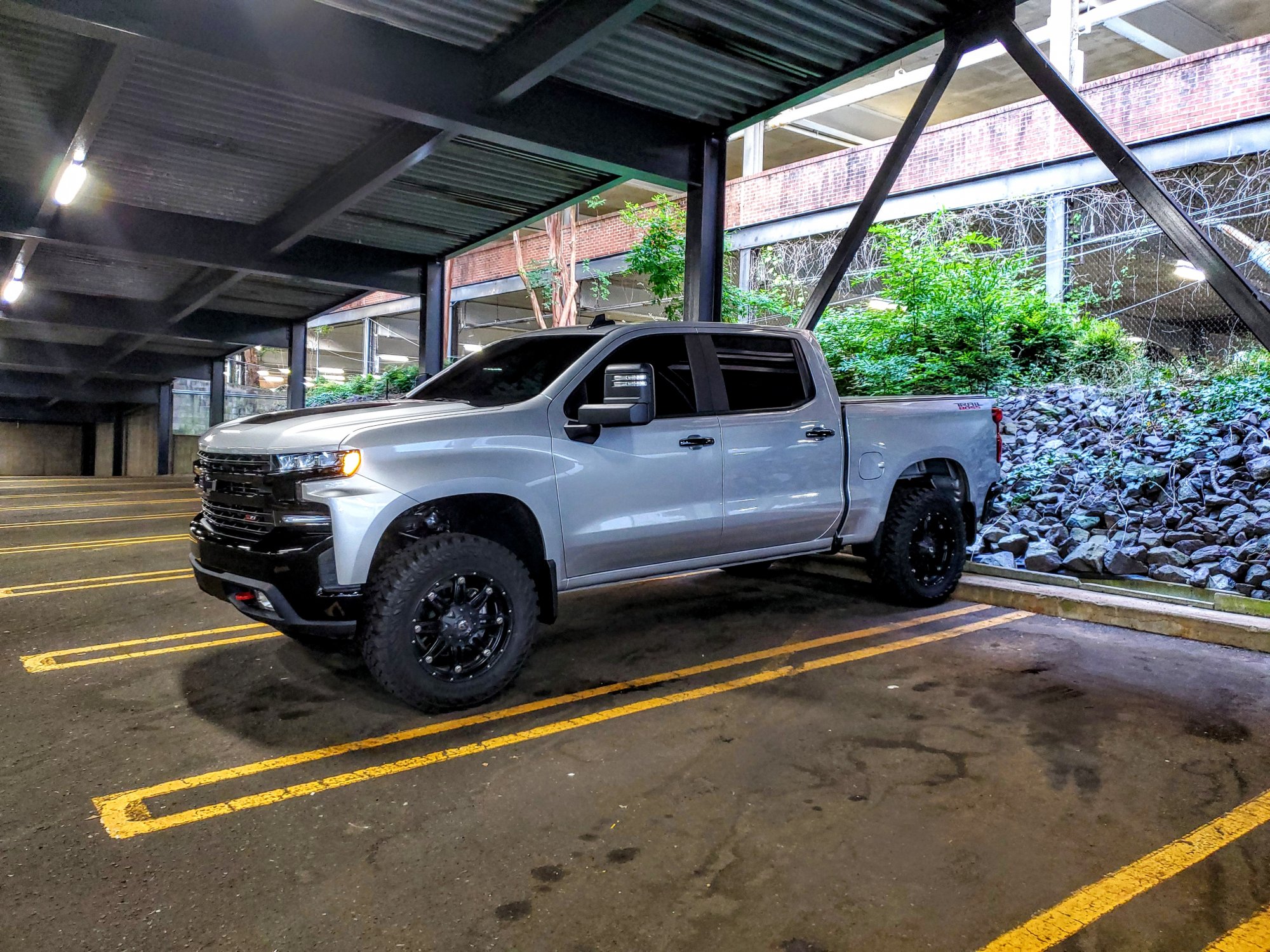

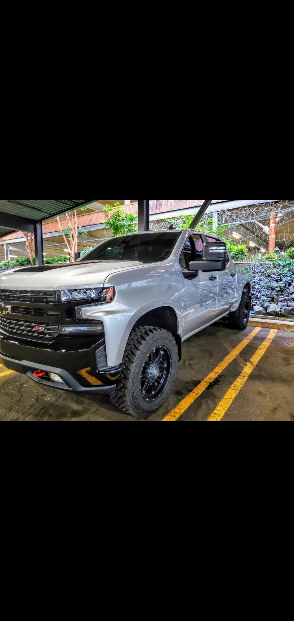

Is there any rubbing? Do you have any pics at full lock inside wheel well? it looks good!
Thanks! No rubbing so far but it’s pretty close. I’ve reversed it and gone forward on my driveway at a decent turn/speed to see if it would rub and nothing. I’ll report back if I do later. Hard to tell by the pic but the tread is about 1/2-3/4” away from touching.
Thanks man, i appreciate the response.
2020 trailboss with the 2" SST READYLIFT kit (4" total... 2" gm, 2" readylift) sitting on 20x10 +0 with 35x12.5x20 geolander MTs (changing them to Falken Wildpeaks At3w in a few days tho)
She sits good. Nice and level. Honestly with the tow mirrors, lift and 35s it reminds me alot of a 2500. It sits big and proud
