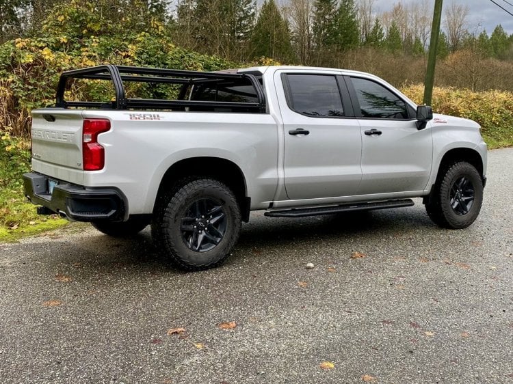

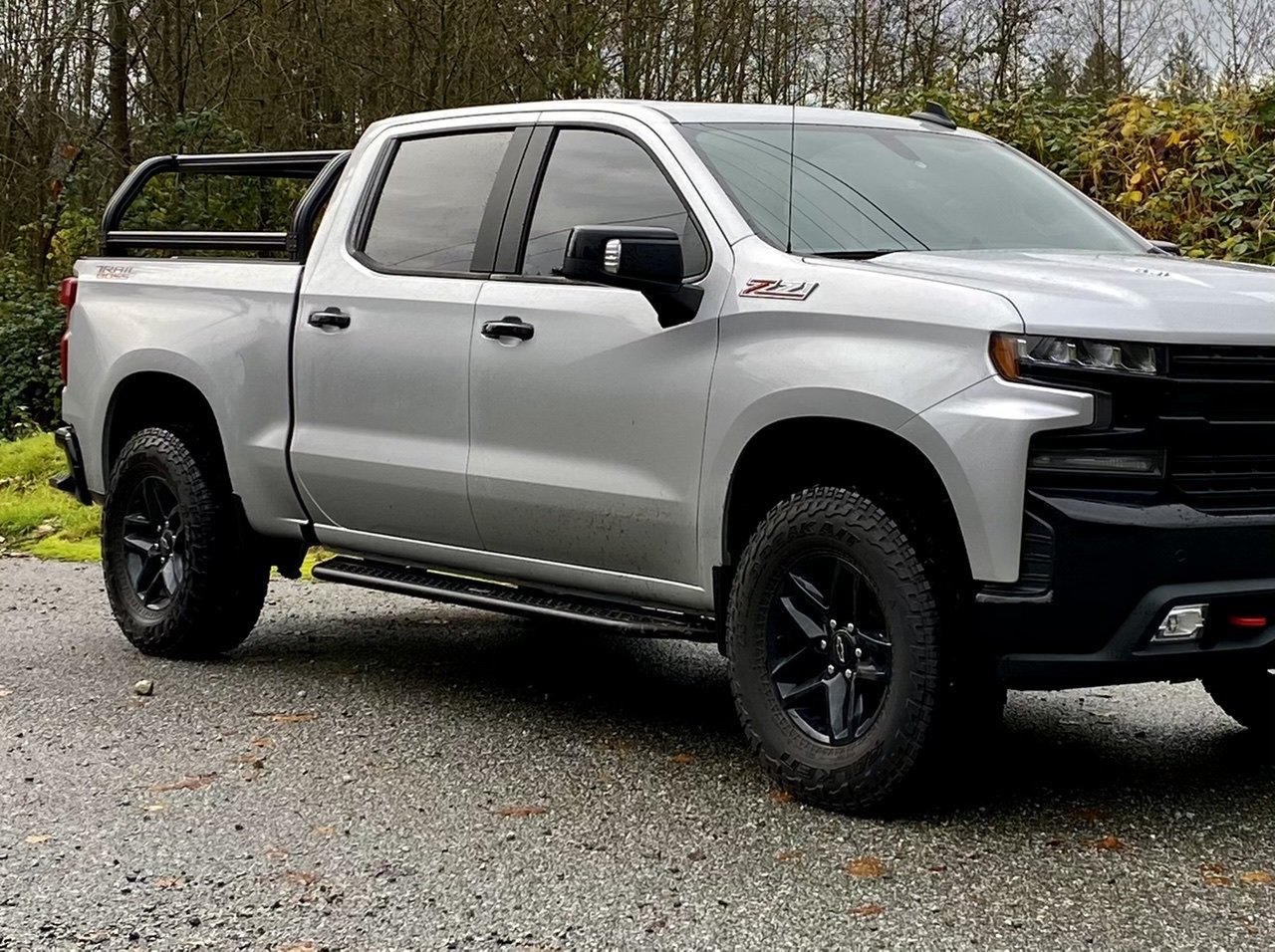

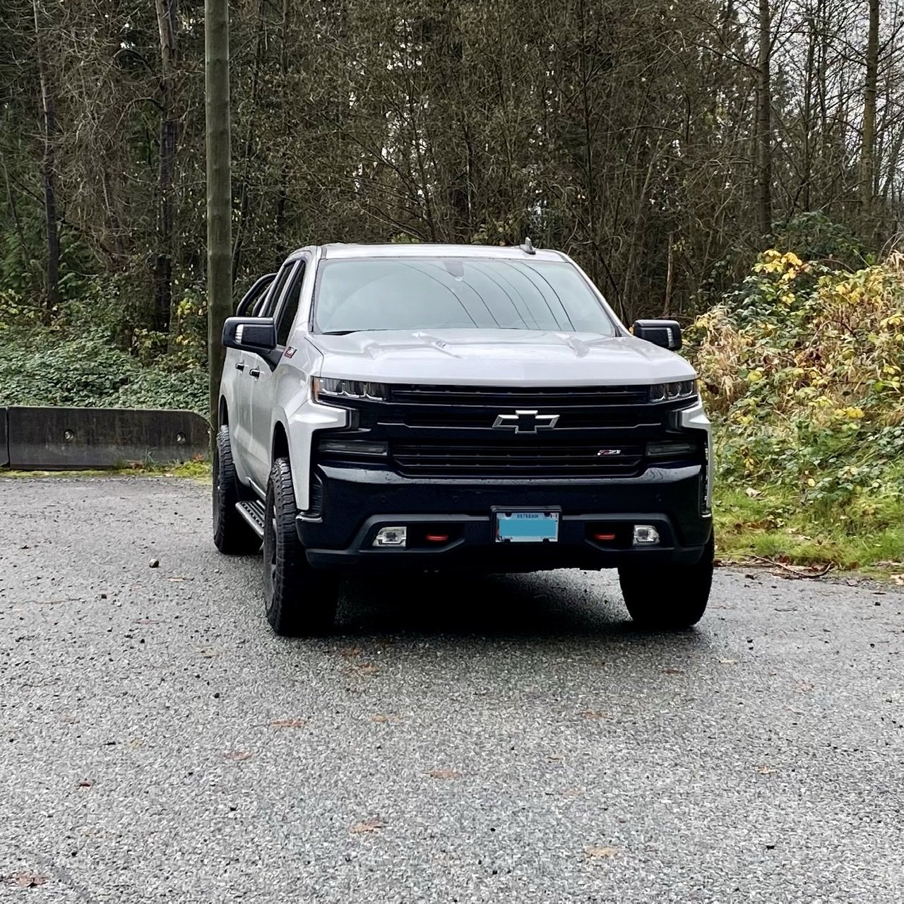

Ready Lift 2" SST for TB
17x9 Fuel Zephyr
315/70/17 AMP Terrain Pro A/T's.
NO rub at full lock going forward, only a bit of rubbing at full lock in reverse on the mud flap and juuuust a tad on the felt fender liner. Haven't gotten around to playing with spacers or doing any trimming, but I'm sure anyone with just a bit of experience would make light work of getting rid of the rubbing all together.
Stock suspension Trail Boss with 295/70r18 Falken Wildpeak tires and 1.5in BORA wheel spacers. Just the right amount of stance and lift in my opinion. No rubbing at all since I trimmed the front mud flaps and removed the little brackets hidden behind them.
