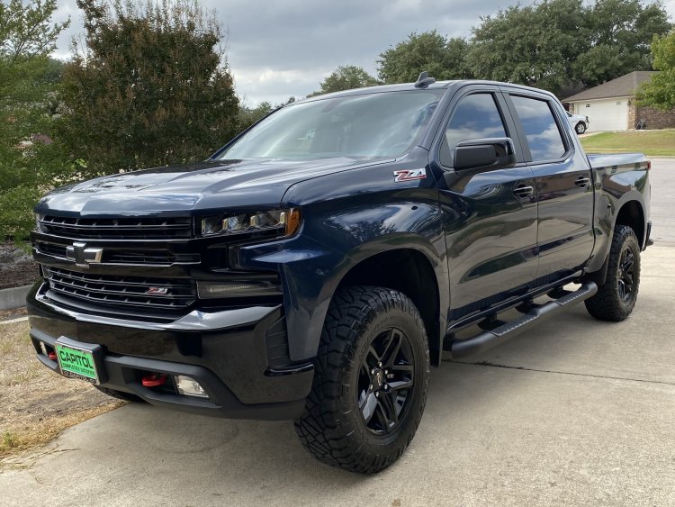

295/70/18 Stock Wheels Nitto G2 Grapplers. No rubbing and drive better than the Goodyear stock tires. I do have a Rancho Leveling kit, but the tires were put on and run for at least a week before I had the kit installed. Either way, perfect without any problems.
Is that pic before or after the kit? Also, what type is the Rancho leveling kit and how big is it? All I’m finding are the kits for non Trail Boss models
That is the picture after the leveling kit and tires were put on. Whoops on the Rancho. I meant Rough Country. Sorry. It is a 1.5 level. Here is the link: https://www.americantrucks.com/rough-country-silverado1500-150-inch-leveling-lift-kit-1321.html?utm_content=AT Lift Kits - Leveling Kits and Body Lifts|Rough Country&T5_Var4=S114086&utm_campaign=ATS+Silverado+Brand+%26+Vehicle+Low&dialogtech=ppc&utm_source=bing&utm_medium=shopping&T5_Var2=shopping&T5_Var3=red&msclkid=e7bc51f603d714af4d340ef448d401d2&utm_term=4577816664592493&gclid=CI6D2u-Lt-oCFV2rxQId0O8CXw&gclsrc=ds

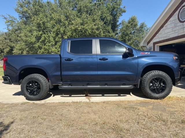

Factory Trail Boss suspension.
1.25" BORA spacers.
35x12.5 BFG KO2s.
Removed mud/aero flaps. Removed front wheel well brackets. Pinned back front wheel well liners with self tapping screws.
Almost no rub. Tire kisses felt liner at full lock.
