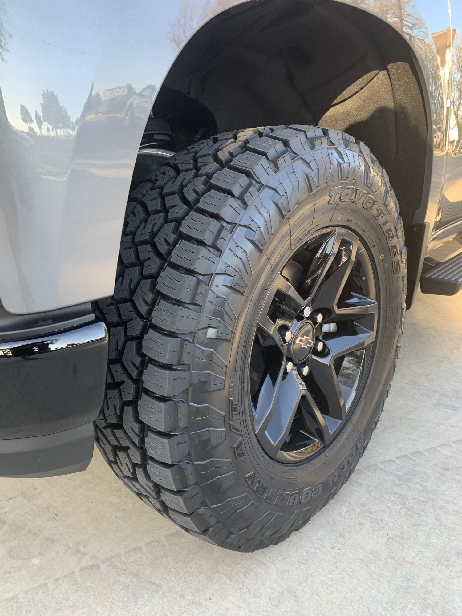

On 11/19/2020 at 11:52 PM, TrailBoss401 said:
Thanks to all the info I read here, I just put Toyo Open Country AT3’s, 295/70/18s, on my 2021 Trail Boss. Wanted to avoid any further suspension mods and keep with the factory wheels so I went this route. I’m very pleased with these as they really filled the wheel wells in better but without the excessive weight and drag of a larger tire, wheel, lift combo. Smooth running tire, no rubbing at all, fairly quiet on the highway also.
Looks perfect. x2 for me on holding off on leveling mods. You still happy with the Toyo's on the stock suspension and rake? I'm looking to do the same on mine.
I went very slight on the "oversized" part. From the stock 275/65-18 to a Ridge Grappler 275/70-18. Subtle yet slight. Works for me.
Yes, I have 4000 miles on it now and am extremely pleased. These Toyos are exceptional.
Thats great. Thanks for the update. I guess my last question is clearance when in reverse as others with other tires have seen with the 295/70/18 size. Still no rubbing for you? Appreciate the feedback!
