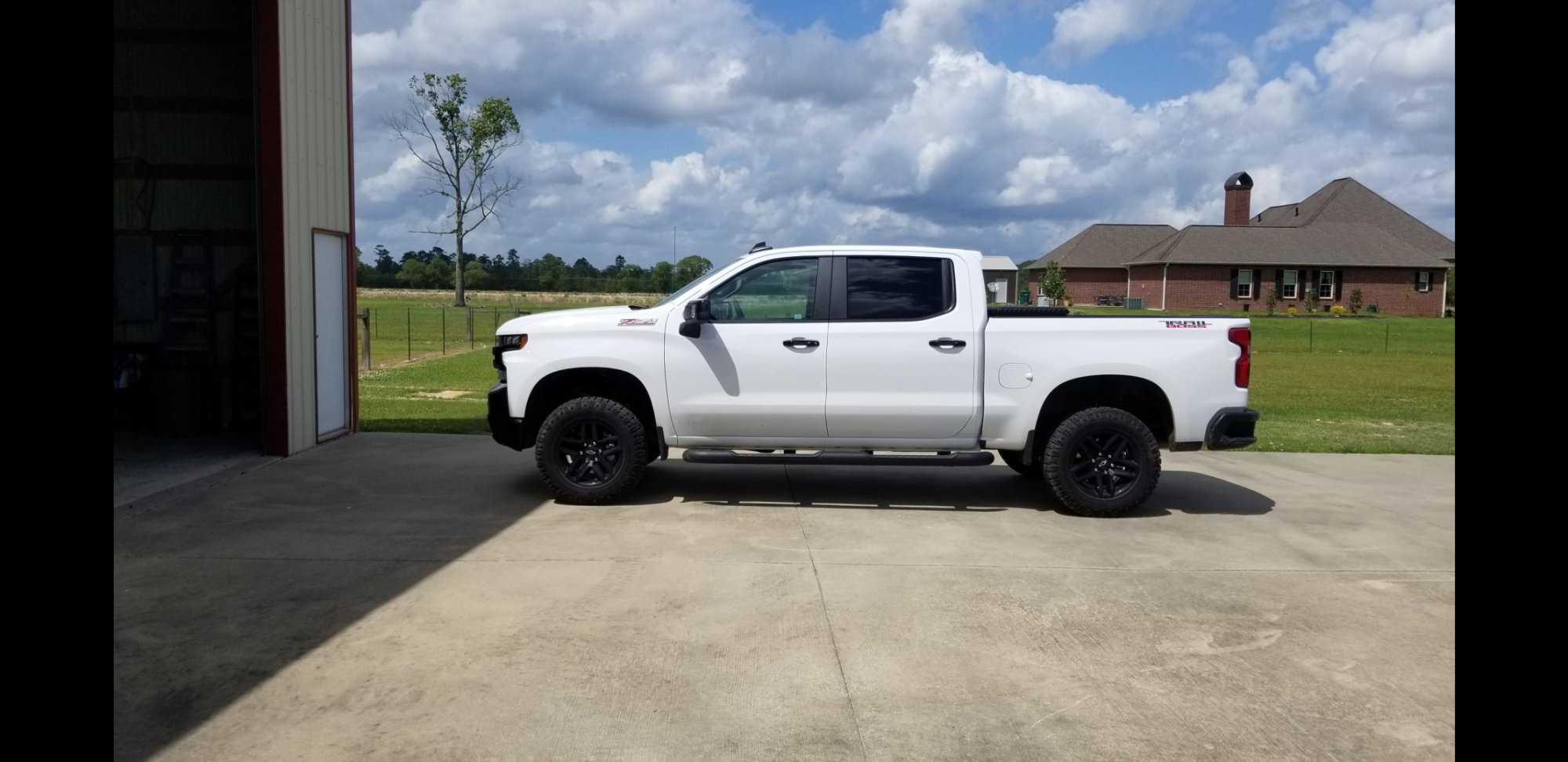

I went with a 1” motofab lift, Ridge Grappler 305/55/R20, fuel Vandal 20x9 +1 offset.  We had to remove the bracket behind the mud flap as it was pushing the mud flap forward and making it rub against the tire at full lock.  After removal, we were able to push the mud flap back about a half inch and now have zero rub.

No issues here, I stayed on the safe side and just went with the 1".  I know a lot of others were going with the 1.5" but I really worried about using either of those.  But a guy on the FB groups said he personally talked to Motofab and they recommended going with just the 1".  So far no issues and I love it.  I started with a 2" rake, now I am at about 3/4" rake.
