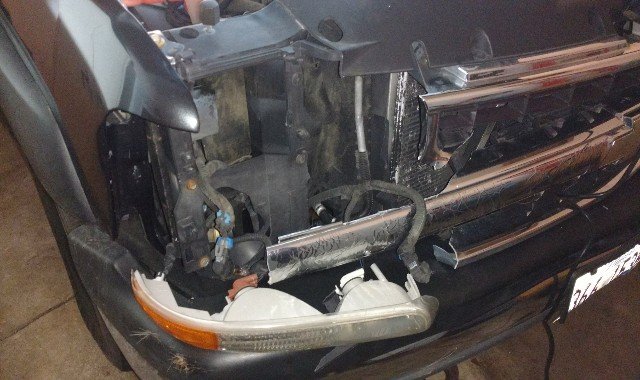

2003 Tahoe accident tonight no headlight pass side.
Hit a deer tonight. Can someone please walk me thru diagnosing why passenger side hi/low lamps inop.

Bulb blown (it doesn't take much of a shock to the bulb to cause it to fail)...remove bulb from driver side and install on passenger side to see if it works; if it works you know it's the bulb
Wiring harness come off of bulb, wires cut
Check fuses

How bad did you hit the deer? If the headlight in place or did it get completely knocked out? Check the bulb first followed by the wiring. Each side has its own ground wires going to frame.
Pictures if ya got'em
Bad bulb..... This truck maintained it's composure, like can't believe. 60mph big doe. Not playing.
