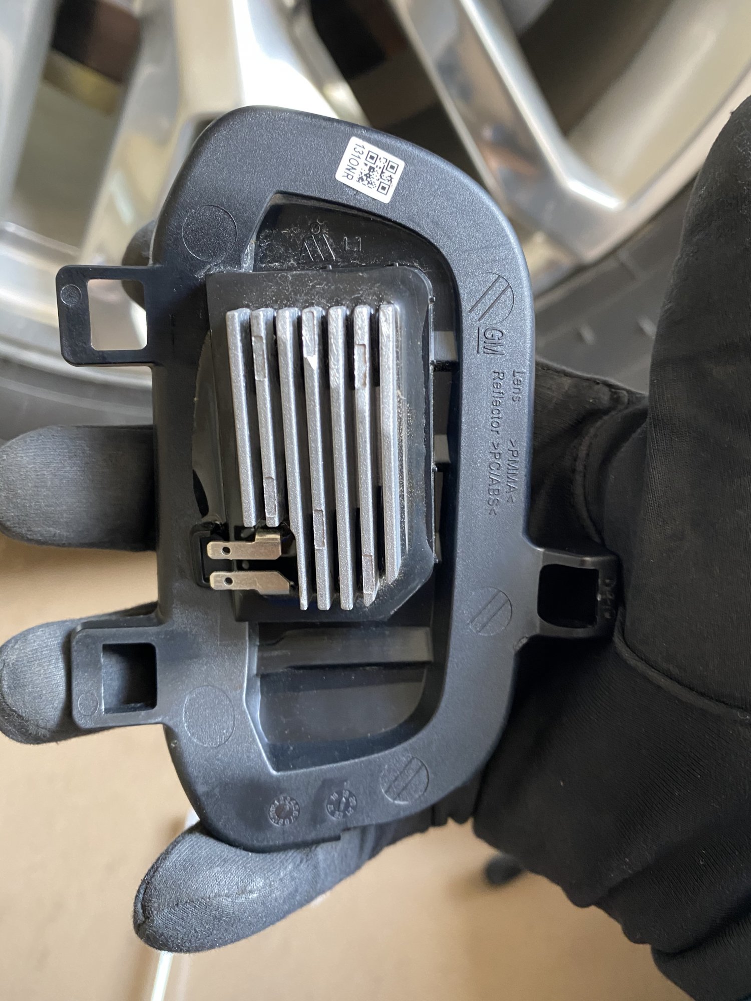

Does anybody know the part number for the light in the mirror I was driving down the highway and a rock hit the light and chipped the housing and it just looks bad with a big hole in the middle of the light and water is getting inside?? Part number??
Edited by AngelG.97
  • 8 months later...
On 5/25/2021 at 3:30 PM, Anjac12 said:
Is there a work around to get the mirror lights to be turned on while the truck is in gear?
Boostauto makes a harness for it. You can run them when you put the high beams on.
A lot late to the party, but 3 posts up, the one and done is asking for a part number???
There is a QR code right on it in plain site, how do you afford a new truck when you can not even figure that out🤔
