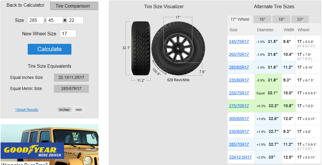

Closest in diameter would be
275- 70- 17
They are .06" taller and .39" narrower  .
Got this from Discount tires tire size calculator
