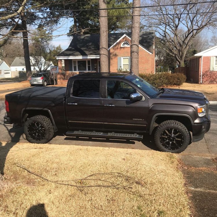

I have a leveled 2017 gmc sierra, iv always hated the chrome rims that came with it so I recently decided to get new rims and tires.  Wow am I overwhelmed with the different options.  I finally found something I liked and now my tire shop is saying it wont work with my truck......TO much trimming would be required.  in the picture is what I'm wanting to do....it has 20x10 fuel rims with 33x12.5 nitto trail grapplers on a 3.5 rough county lift.  I'm wanting to do almost the same setup but run nitto ridge grapplers in the same size as the trail grapplers.
after tire shop said it wont work Iv been googling around and I see may others running this rim/tire combo with little to no trimming.....so I'm confussed.
can someone help he here?
please and thank you!

Appreciate the positive input. Currently, I’m running Fuel 20x9 +1 offset wheels, 34” Nitto Ridge Grapplers with a 4.5” CST Lift. I was running the same wheels but with 33’s when just leveled. I couldn’t recommend doing anything as far as a level taller than 2.25” cause max would be 2.5” and still recommend new UCA’s. Leveling gave me a rough ride so I switched to lifting with very high quality lift company that didn’t widen my track width or turning radius.

As far as going 20x10’s I wouldn’t be the one to ask cause I’m not into any wider wheels than 20x9’s. If you’re looking at keeping your truck for many more years to come then I’d highly recommend doing a lift cause it’s very well worth it. There are plenty of guys on the site much more knowledgeable than me especially with 20x10’s. Again, leveling doesn’t give you as well as a ride as lifting with a high quality lift especially with coilovers, that’s just the bomb.

I'm running a Zone 4.5" with Bilstein 5100s set at 1.25" and run 33" Nitto Ridge Grapplers with 20x10 Provas in the winter and 22x10 AF Grips in the spring/summer/fall. I have no trimming and don't rub at all.

I have a 2015 GMC With a RC 2.5” level with 33X12.50 duratrack tires, MOTO 20x10 -24offset and they rub a good bit on the drivers side back of the finder well (clears front fine).  I’m going to try some trimming this weekend base of this video from custom offset.

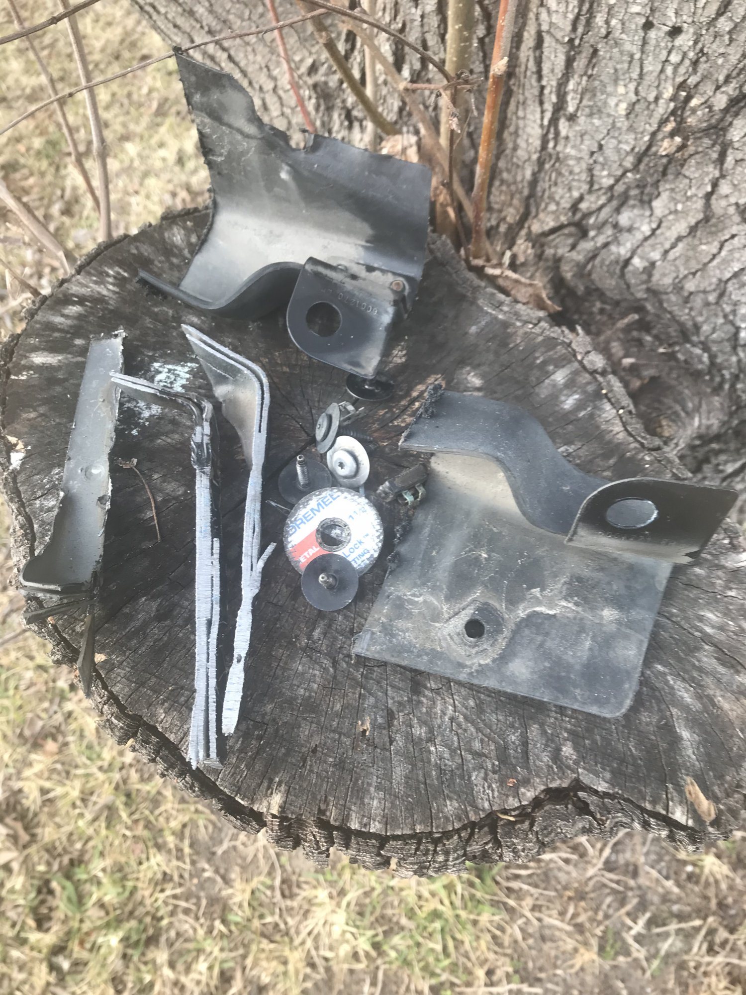

Job is not complete unless you have left over parts.  Lol. Did the trim job today really only took 15 mins per side if you confident in what your doing.  I would have a small grinder on hand aswell, I had to use it to get the saw started and round a few edges.
