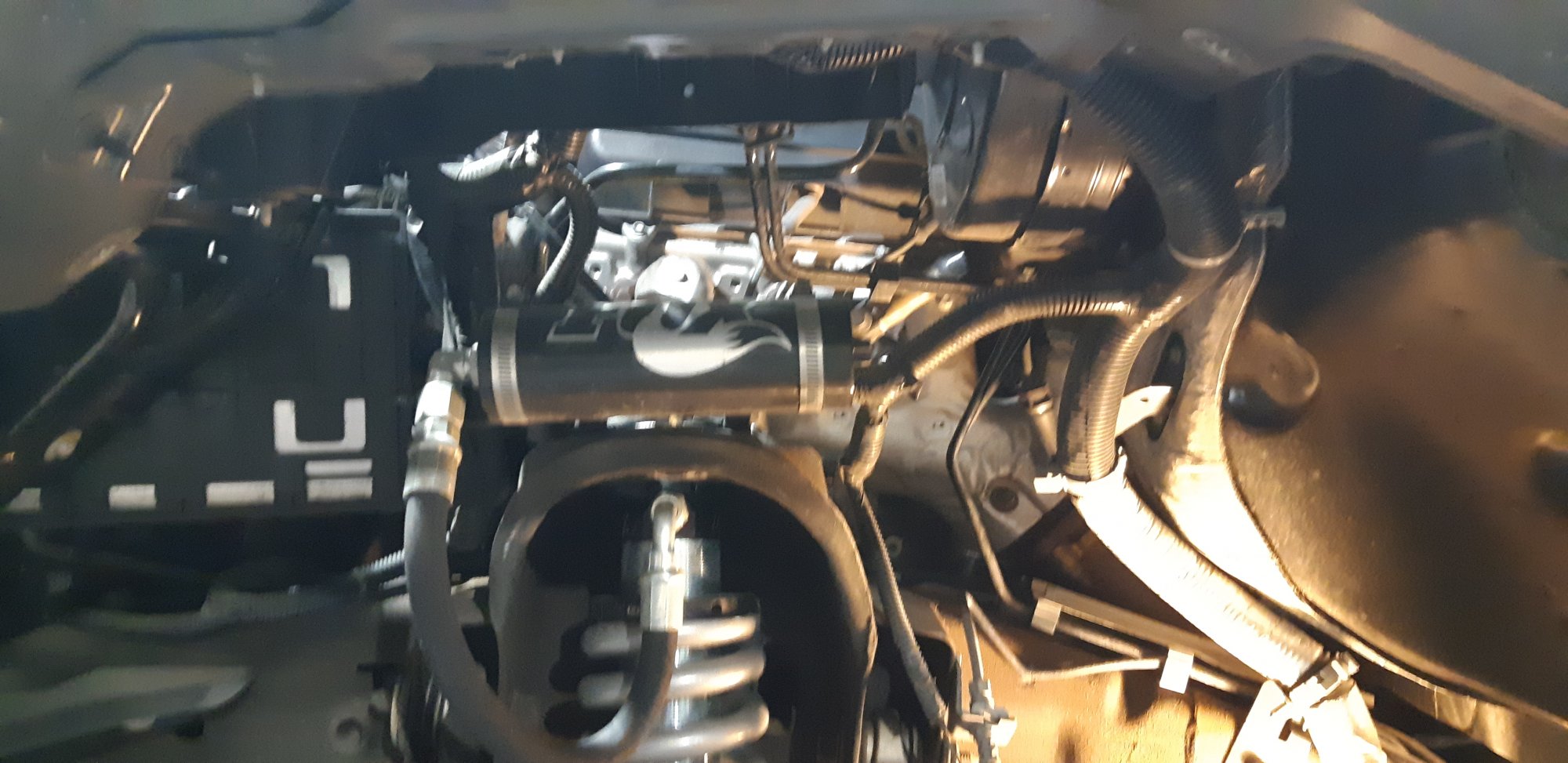

Honestly, this wasn't as bad as people have claimed. I think they had a hard time because they tried to get to the plugs from the top. Going from the fender area makes it pretty easy.
Mine truck is lifted..    was much much easier from side....   was even easier when removed the heat shield of the manifolds ..
Ohhh and that pocket where the fender well / fire wall/ side panel meet up was so full of debris....  acorns leaves and pine needles....   didnt get a pic. But it was full...
