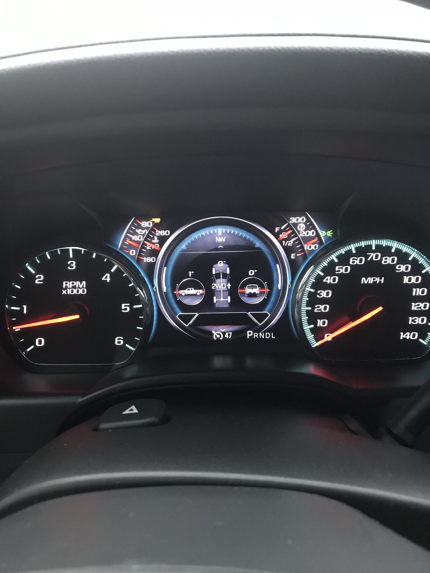

I honestly don’t know but I don’t think so...I never use that view, I do what you’re doing and go the manual math way...I have my Yaw, Pitch and drive status showing full time.
