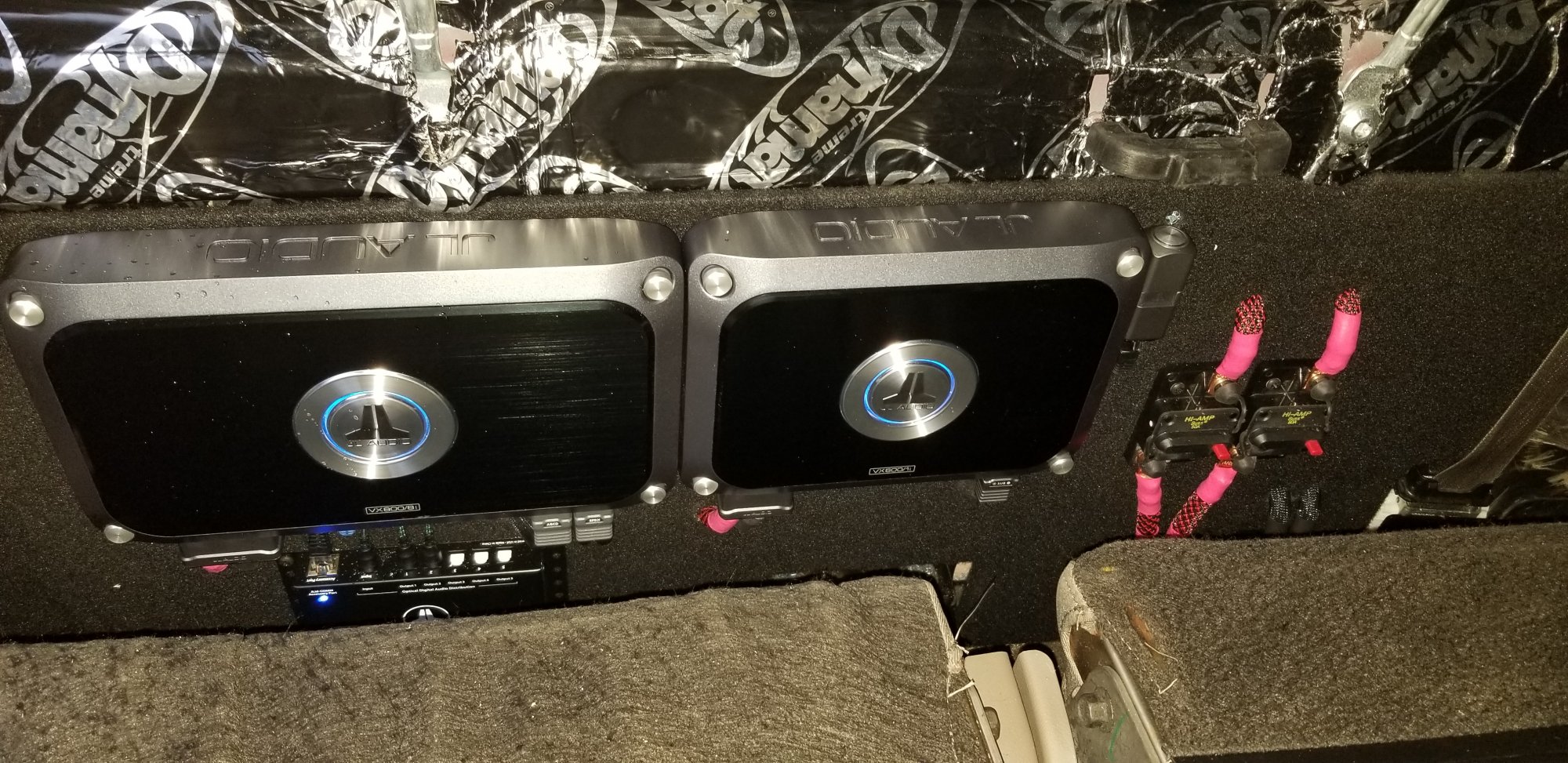

Best one is NAV-TV. I have it. Its $850. But its perfect.  I use a single optical cable that goes to my jl hub and then another single optical to each amp. No rca wires. The best thing is that it wont amp your chimes. It only extracts audio from the stereo system.  If you do a system, do it once.... DO IT RIGHT...20180721_194332.thumb.jpg.55f7efa6104a1345a475e0ad472e9bc1.jpg
Only issue with the nave tv is it "for bose"  its 850 and if you have a non bose you have to buy their flashed radio module for another 200 and have the possibility of loosing car play/android auto.  They are hit or miss.  Ive talked ti a few people to who have the nav tv unit and they say its a hit or miss
Yeah. Not sure about non bose. And also not sure about the android auto. Since i had base and no android auto, i cant speak about those.

I spoke directly with nav tv and they told me the same thing. They also said "if it doesnt work send it back"  i also know 2 people with the module i posted with non bose and they say it does exactly what its supposed to do and who actually compete in sq.  So its the correct module for sure for vehicles without bose.  Not knocking the nav tv but its just not for me
Sorry meant to say Bose, not base..
And yes. Its alot of money for an adapter. That can be had cheaper. At the time of my purchase, it was the safest bet for me.
