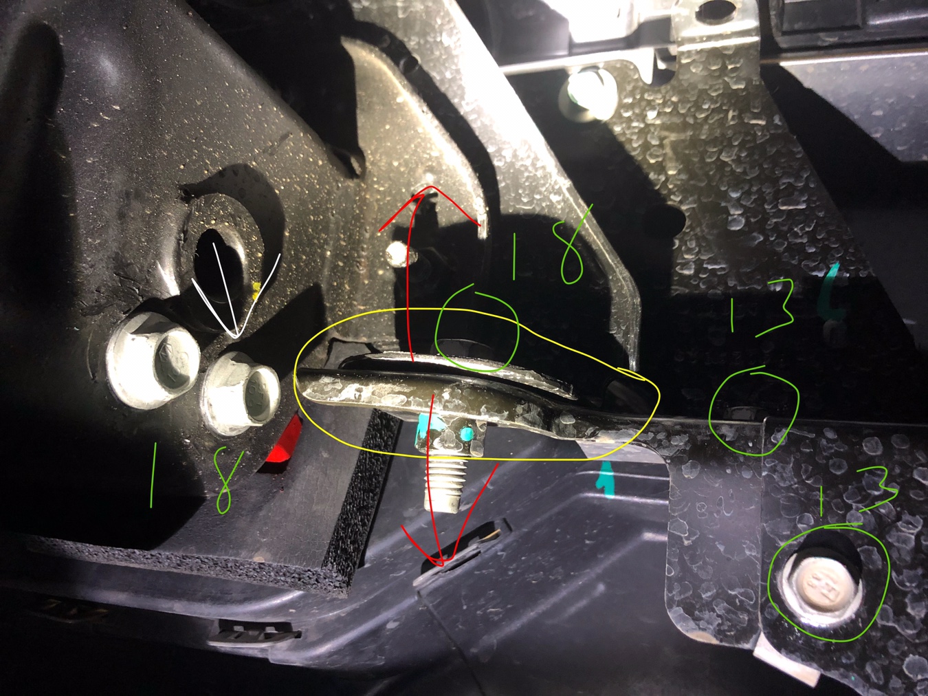

Alright, passenger side is a breeze, no issue at all outside of the little plastic flap and rubber spacer that you have to muscle the new hooks into.
Drivers side: in order to remove the 4” bolt you’re going to have to do some extra work (see picture). I took out the 1 18mm & 2 13mm bolts holding these 2 pieces of metal together that are in the way. I then used a flat pry bar (one used in flooring) and proceeded to open those 2 pieces of metal up. It’s best to pry with one hand and slip it out with the other. You’ll have to do the prying again to get the new one in. Such a PITA, but doable for us average guys.
I was too focused on the task to get pics during but here’s the area with some colorful arrows and circles [emoji851].
Yellow=the 2 pieces needed pried apart
Red=direction the metal needs to move.
Green= bolts needed removed
White=long bolt that has to come out and replaced. IMG_0451.thumb.jpg.6dd07f2b995f15be736056363f6c0249.jpg

Are those the painted factory hooks? Mine came with new hardware, so I just used a sawzall and cut the bolt on the drivers side, then used the new one with the hooks, pretty simple.

It wasn’t that bad.  What you’re saying is to put the bolt in backwards?   Good idea.
I’m going to sell my old ones so the bolt will come in handy.

Yes sir, you just cut the head off of the one from the factory, then it just slides out, reverse the new bolt as it should have been put in the first place.

Been on here for a while, along with the other posts on how to install them. That is how I found out about cutting the head off of the bolt trick.
