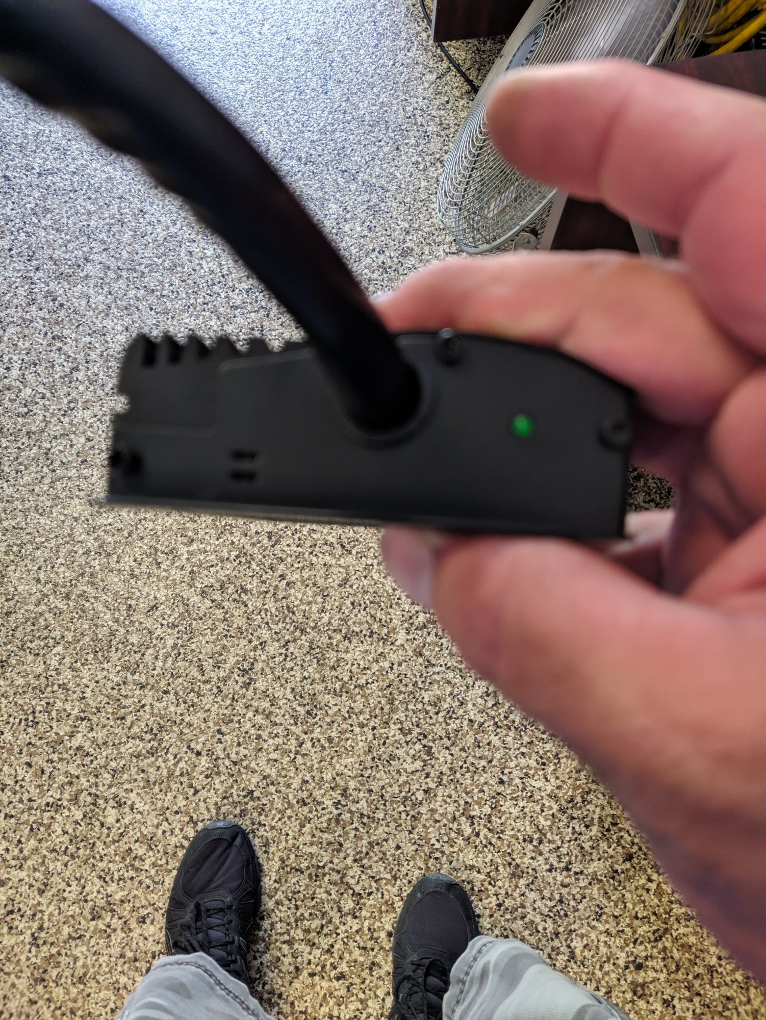

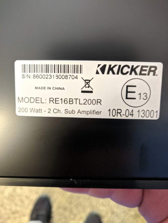

Does anyone have pictures of the KICKER PowerStage  Subwoofer amplifier (The one mounted on the sub), specifically the wiring harness and model number? I have a 2018 with the VVS Kicker System, and it doesn't have any DIP switches and option for the CXRAC Remote Gain Knob. I called Stillwater Designs and asked how I can add the Gain Control, and they said it wasn't possible. If the Sub amp has the same wiring pinout, maybe I can buy the 2019 sub amp with the gain option and install it on my 2018 Sub.

I have the Powerstage system with 2 amps, one got mounted up front above my brake pedal, it has DSP, crossover, and amp. I'm only looking to replace the sub amp so I can have control of the output. Yes, it makes sense it's speaker level inputs and power, but it appears some of the wires go from one amp back to the other.
I ended up replacing the amp with a powersports amp from Best Buy. I had to change the wiring to the sub to increase the impedance, as the included sub is a 1 ohm dual voice coil, but wiring it in series increased the impedance to 2ohm.
