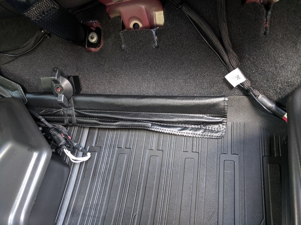

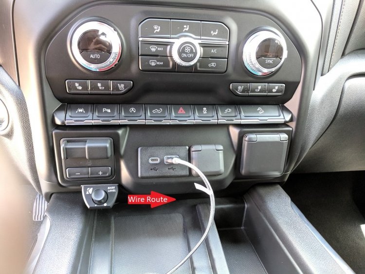

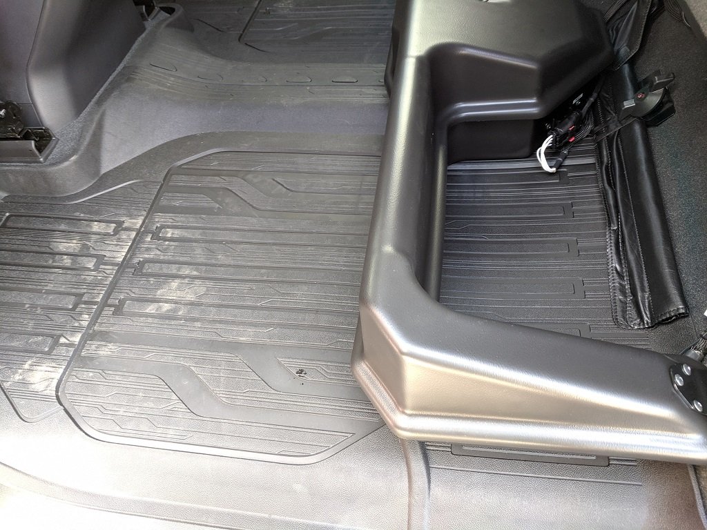

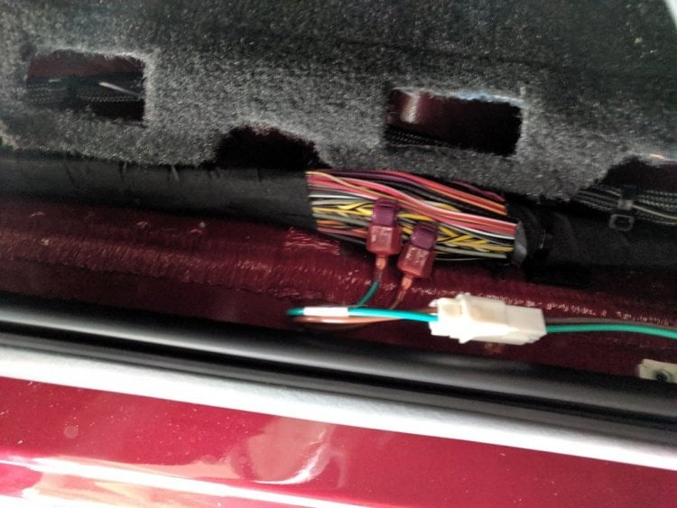

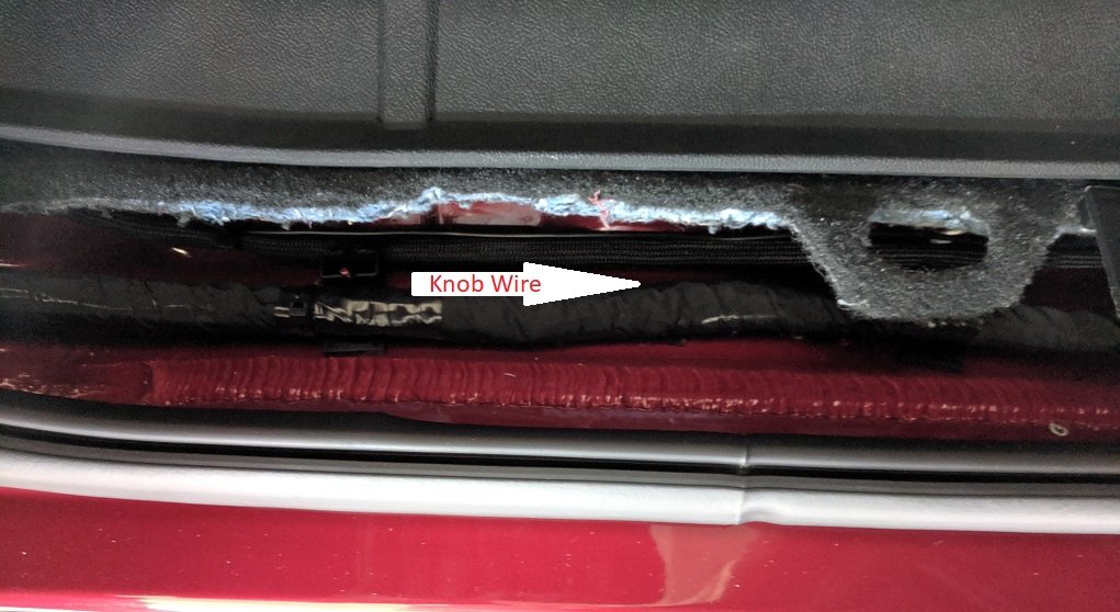

As promised, pictures of my install and some notes.
1. I couldn't remove the right kick panel on my truck. Seems stuck so I had to use another ground point. There is a ground point (long bolt) behind the big blue plug in the fuse box. Also had to tap-off in the passenger sill because of this as shown in the pictures.
2. The install guide said to tap-off a twisted yellow and yellow/black pair in the wire bundle. I couldn't find this pair in my truck. The closest i found was a twisted yellow/gray and yellow/black. I'm a engineer by trade and these 2 sets of wires are not the same. Nevertheless, i contacted kicker support and they suggested i test the yellow/gray and yellow/black pair for dc and ac voltages. This worked. Not sure why the coloring in my truck is different. I have confirmed this is indeed the right front speaker by fading completely to the left and the bass goes away.
3. The knob wire is long enough to route through the cable channel. This is what i did. Zip-tied everything together. Stuck the knob under the trailer brake with 3m vhb and it fits perfectly. The knob wire routed cleanly.
4. Didn't have to cut any carpet or floor mats as mentioned in the install guide.

The carpet cutting is for hiding the wires underneath and also a cleaner install. I initially did the same but after I put something in the small storage area and pulled the harness up I decided to cut and route under to avoid this in the future. I also ran the volume knob wire down the driver side and mounted the knob low on the driver side so it cant be seen. That knob is an indicator that there is a sub in the truck and don't need anyone thinking it's worth breaking into.

See my post and pictures above. Didn't cut anything. You can lay the wires on top, route them behind the seat anchors, zip tie them nicely and it's not messy. You will not be able to remove the floor mat easily if you don't cut it but i'm ok with that.
