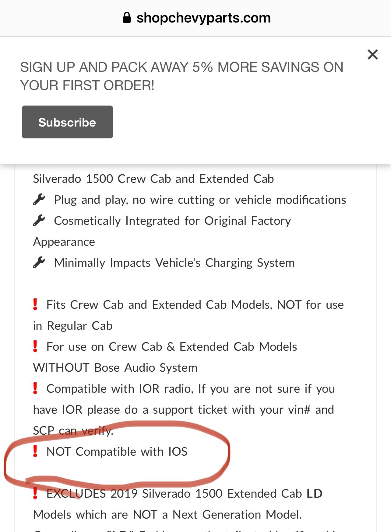

On 12/3/2021 at 11:29 PM, Gmoeller said:
The part #19417166 specifically says not compatible with IOS system.  And I have the IOS system. 😞
But thank you for responding.
