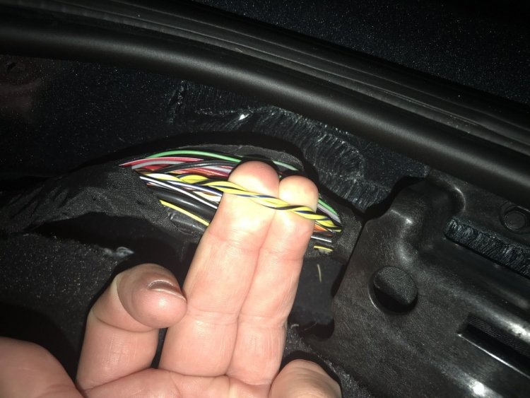

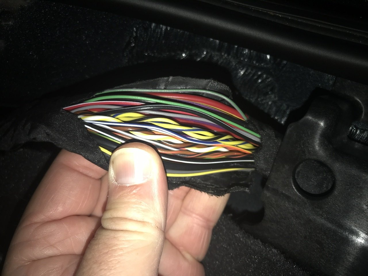

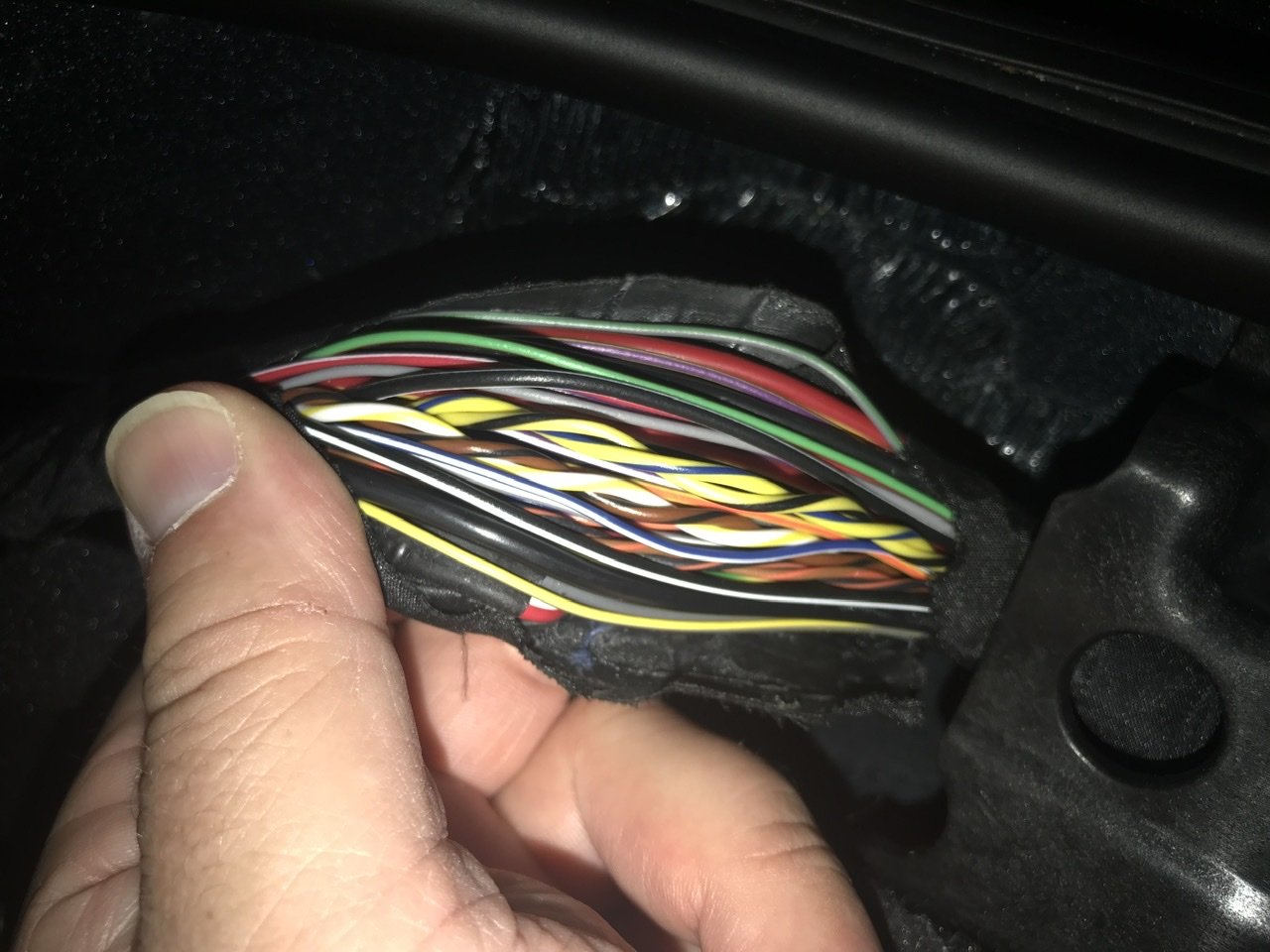

Can anyone offer some direction on splicing for the kicker system?  I am a bit lost on the wiring...
I want to get this right.
I read every post on this, found a lot of helpful info. Strange that is such variability on the colors.  Yellow/black and yellow/blue for me. Thinking to go brown/yellow/black and green/yellow/blue.  I also wasn’t sure if I was too far down on the wiring...
Appreciate all previous posts and any new ones.

I just went for it.  Works great!  Fade/Balance works as intended.  Control knob should be here Monday.
Already love this system. It’s not the system of my younger years, but it’s clean, punchy, and preserves some of the storage.

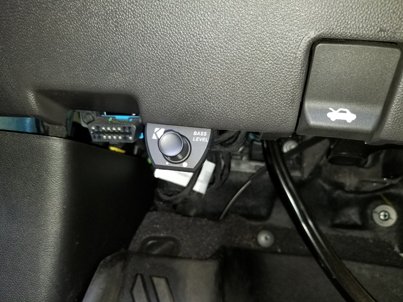

I just finished installing the Kicker sub in my 2020 AT4 with Bose system. I also added the Kicker CXARC control. I played around with the Kicker Amp's dip switches and decided the factory setting is good enough (1 up, 2-3 down, 4-6 up). I have my Bass EQ set to 0 on the head unit and the CXARC set in the middle. One thing to note when installing is you do not need to cut the floor mat around the sub (if I need to pull it out I will just loosen the sub box mounts and remove). I tested the sub with Dire Straits - Money for Nothing (CD on USB drive), some other Artists/Songs and Sat radio and it integrates perfectly. Setting the Bass EQ to 0 removed all most of the bass from the found doors which really make a difference.

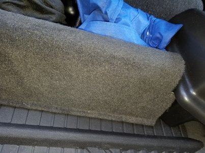

Also on the factory under rear seat storage you have to remove, I am going to cut mine to fit up to the sub box (left side) for the right side and edge with plastic trim you can find on Amazon (need 1/16" I believe). I will cut a template from cardboard so to get a good fit when I cut it.
Here is a pic of the modified GM under rear seat storage so to fit with the Kicker sub, I marked it with tape and cut it with a hacksaw. Also I attached the Amp with 2 sided tape so I can take out to adjust switches if needed easily instead of messing with the hard to access screws.
Can’t get photos to load.
I cut the passenger side of the storage to the sub and plan to cut a section of the drivers side to add some carpet protection where the dealer trimmed the floor mat.

I resized the 2 photos so they should display now. Also I believe you really need the control to get the bass pumped up. There is a good place to mount the control knob right next to the hood latch release on the driver's side (only spot that has a flange lip wide enough I could see).
