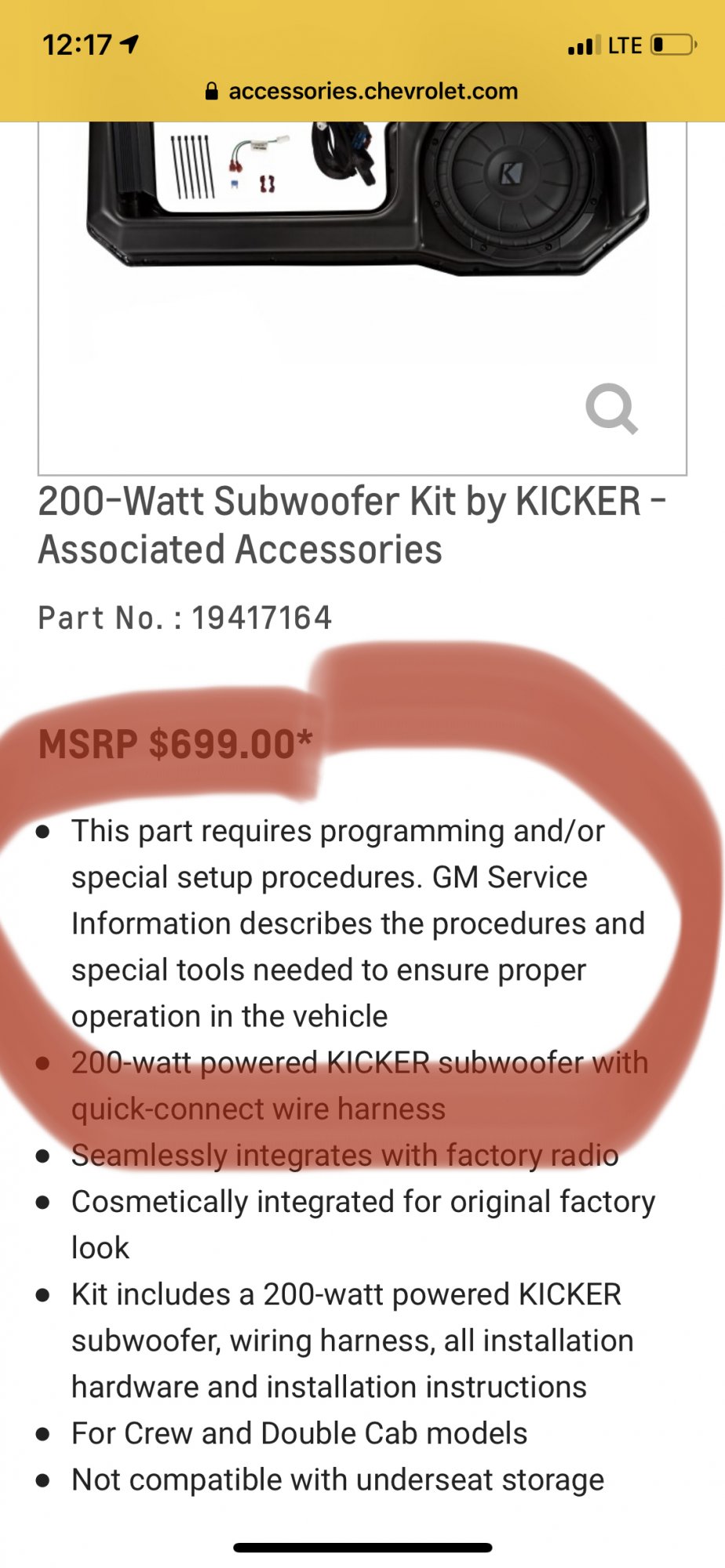

Do you have to get anything programmed at the dealer when installing into a Bose system? I saw this, and it made me wonder...Thanks!
Edited by ausomecasey
I wanna know about this too.
Just sounds like a “we want you to pay us to install it” deal, since that notice only appears on the GM‘s own store and not any of the other vendors. Most people here have installed it themselves, including myself. I’ve never gotten anything programmed for it. Never heard of anyone else getting anything programmed for it either. I wouldn’t think much of that.
  • Thanks 1
Cool, thanks! Mine arrives Monday, and I’m looking forward to getting it installed. Gonna try it myself. I picked up the bass knob today.

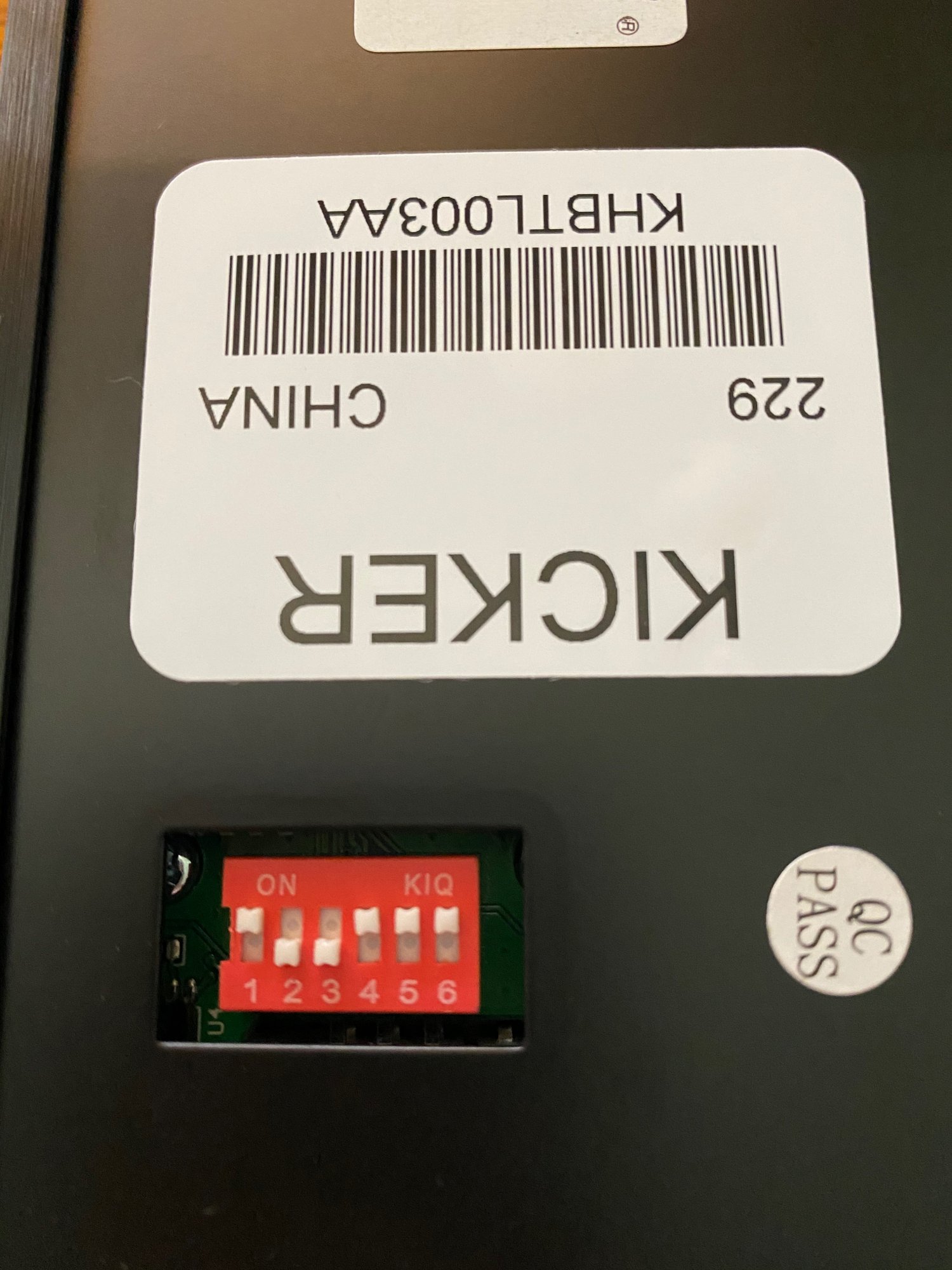

Alright! I have a 2019 High Country with the Bose. The dealer had the truck for 7 hours but whatever. Kicker bass knob was routed myself and plugged in by the dealer. I left the lot sorely disappointed in the bass level. Honestly, max everything it wasn’t much deeper than the stock Bose system. Then I recalled a memory from this thread about the 6 switches on the amp. Mine was 1, 4, 5, 6 up and 2, 3 down. I went all up and BOOM.. there she was! What a complete change those switches made. I tried 1-5 up and 6 down and I’m on the fence as to which I like best. I no longer need bass settings maxed. Finally!
I just installed the Kicker system last week and agree it's a bit weak......
I have not yet checked the switches......how do you access them? Do I need to remove the sub to get to it?
Thanks for the information....
Pop the 4 screws off on the amp. On the back of the amp there is a rubber plug. The switches are in there. It’s my understanding that it comes from the factory preset with 2 and 3 down.
Great.....going to take a look this weekend.
Thanks for the awesome fast response!
  • Thanks 1
Nice! I ended up settling one 1-5 up, 6 down. It seemed to be a bit smoother sounding.
I’ll keep messing with the switches a bit and test it out over a week or so on each. But I definitely recommend either of those 2 options
Just took the Kicker amp out this morning and changed it as recommended to all up except #6......
Very nice improvement and I feel much better about the Kicker purchase now.
Thanks for the recommendations, guys!
