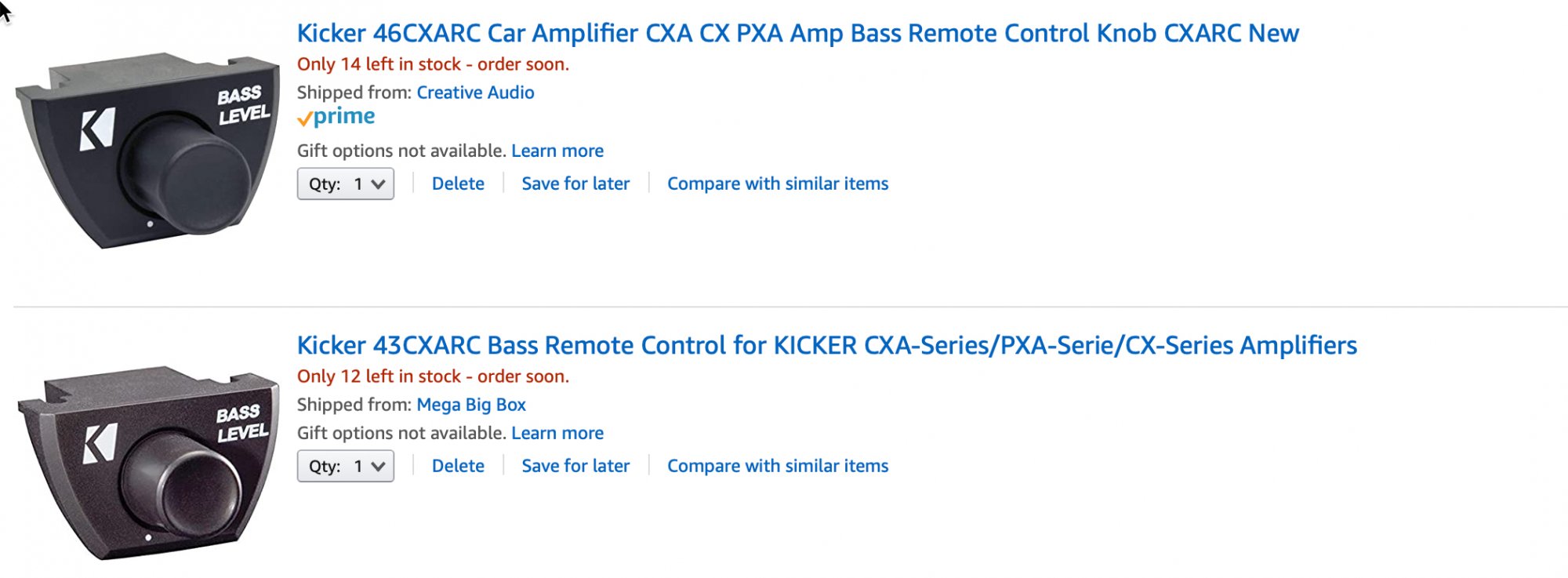

On 4/23/2020 at 5:13 PM, BigMick2020 said:
Here are two different Kicker controls for the Sub, can anyone tell me which one to get......or does it not matter?
https://www.amazon.com/gp/product/B07NS9YV1Q/ref=ox_sc_act_title_1?smid=AJYZ22R6PYFT6&psc=1
https://www.amazon.com/gp/product/B01BDCAWUG/ref=ox_sc_act_title_2?smid=A1WB27YBH8JJWL&psc=1
On 5/8/2020 at 8:27 PM, BigMick2020 said:
I got the 46CXARC unit ($29.95) for my 19417165 Sub and it worked fine......pretty sure it would work for yours also.
5 hours ago, Sjordan said:
Did you end up ordering a knob?  Link?

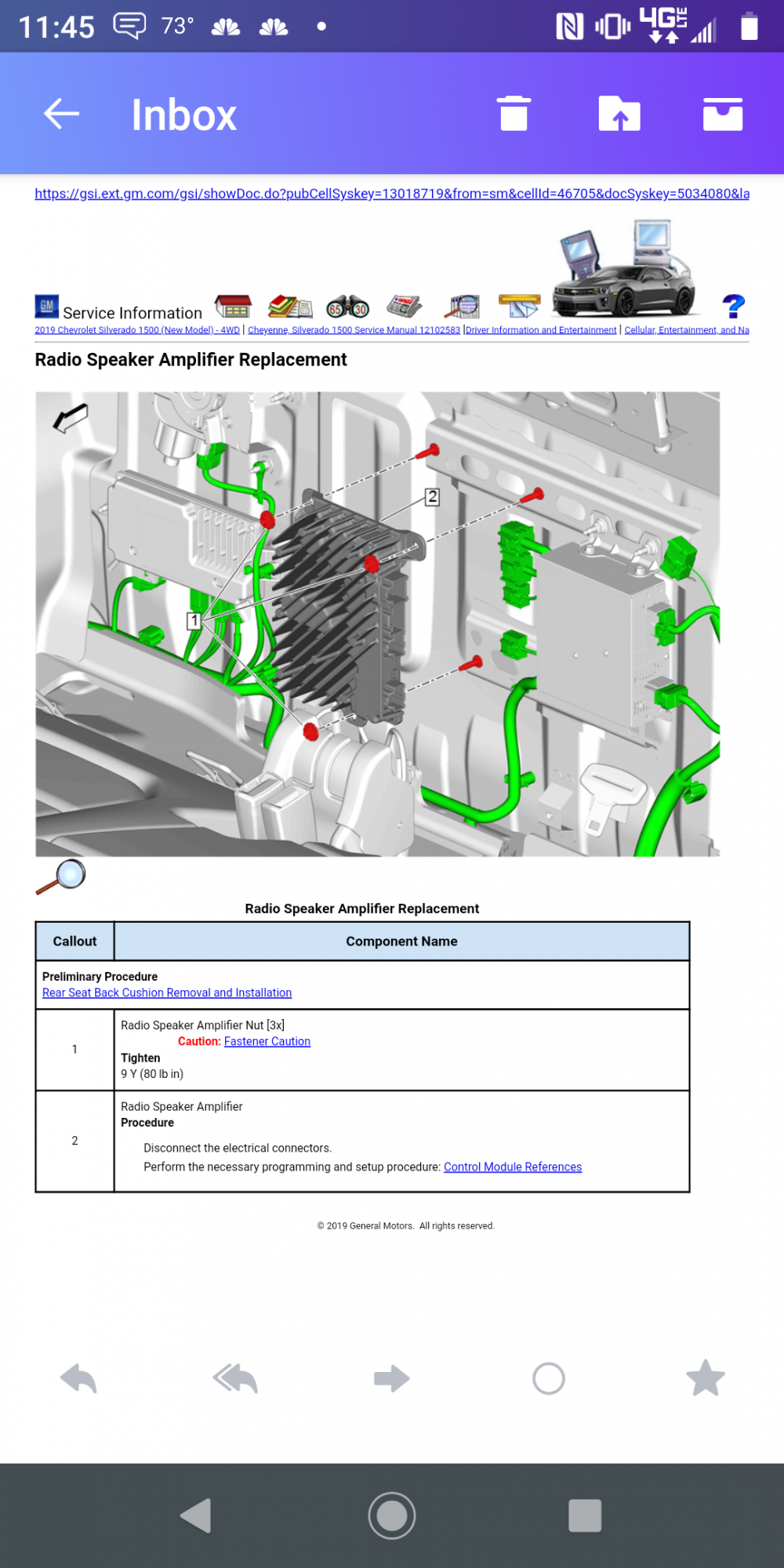

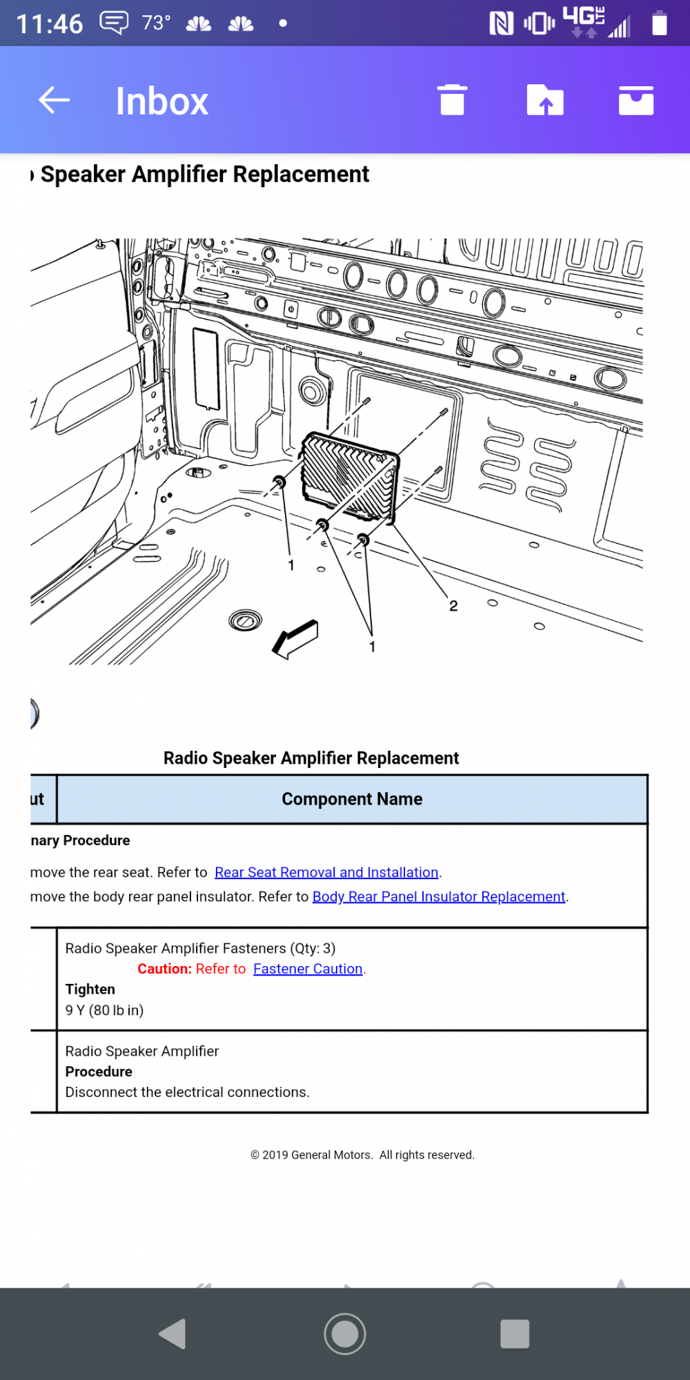

I got the same subthump box and an Infinity Reference Series 10". Just waiting on the harness from John Adams, great customer service by the way. My question is where is the Bose amp located? I have a 19 RST w/Bose and center console.
**EDIT**  BOSE amp is behind the rear seat.  Attached are diagrams describing.  You will need to remove the rear seat.  When I get him to send the instructions I'll update this, but rear seat removal instructions are already on this thread I think.  So, only a power cord will need to be run from the battery, everything else is behind or under the back seat.
