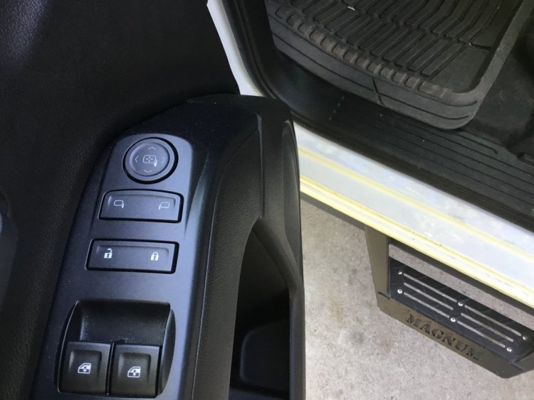

Sir, I am certain this is the type of OEM towing mirror (listed below) I have on my 2017 Silverado 2500HD W/T 4x4 but quite possibly without the heating feature as it is considered a “fleet” vehicle. Rubber floors, basic 4 1/2” screen radio, only cruise control on the left side of the steering wheel, etc.
—DPN – These are Manually Folding, Manually Extending, Heated, Turn Signal, Cargo (also referred to as Courtesy Lamps), and Clearance Lamps (also referred to as Park/Running Lamps)—
Will your adapter give my truck the turn signal feature on the tow mirrors’ forward facing marker lamps even though it is a basic fleet truck(W/T)...?

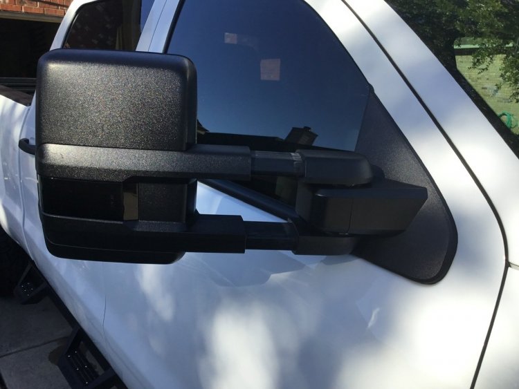

Do you have a pic of the tow mirrors?

Can you send a pic of the mirrors?
