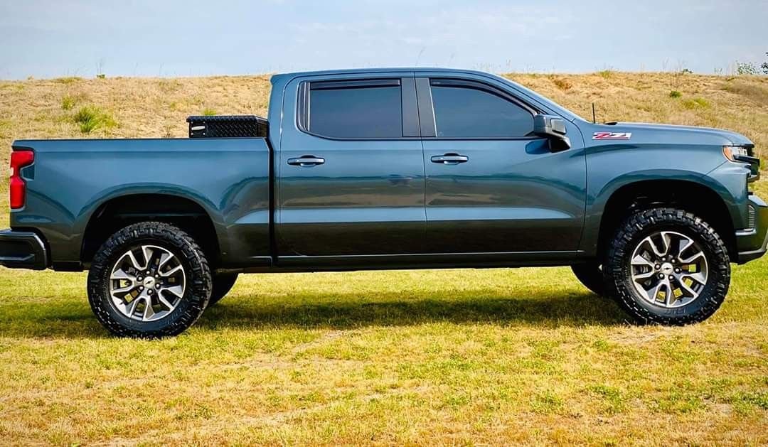

Anyone know what the specs are on this RST? Im guessing RC 3.5” or 4” and either 295/60-20 or 35x12.50-20 trail grappler. Thoughts or ideas?
