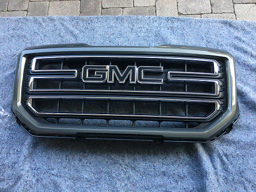

Arrived and ready for paint.  Wish I knew whether I could install the main portion now and snap the outer trim on after paint.  I do not want to do this job twice.
Don’t believe you can do that. Just get it painted and do the job once. Gonna save you time
You're right.  Upon further inspection, there are four screws that mount from the back of the main part of the grill and thread into the outer portion.  Oh well.  It'll have to wait.

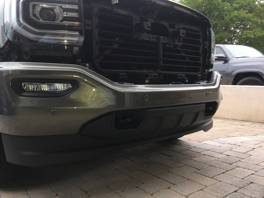

Not too difficult, but getting the "upper cap" (the body colored trim that's just above the bumper and just below the grille) to release from the retention tabs was not easy and it resulted in a couple of tabs breaking on the right side retainer.  Thankfully, the upper cap wasn't the piece that broke because it's $400 and needs to be painted.  The side retainer was $20 but you need to remove the headlight and peel back the inner fender well to replace it.

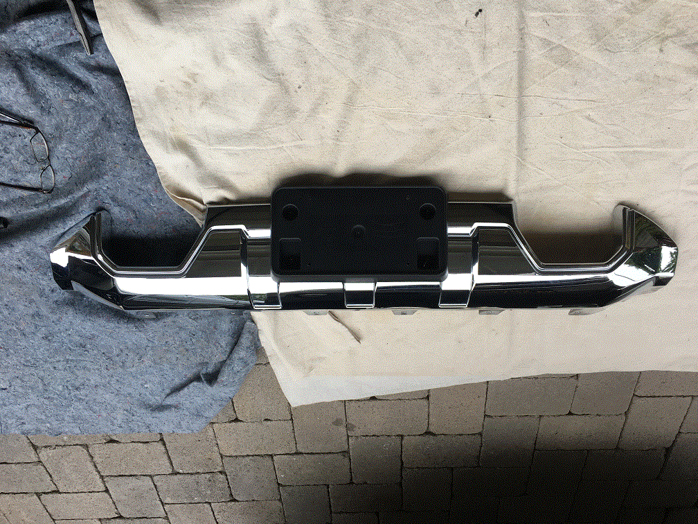

I also replaced the chrome "skid plate" piece that the front license plate mounts to with a black one.  This required removal of the entire bumper because 4 of the umpteen screws that hold it on were hidden behind metal support brackets behind the bumper.  Not a big deal to remove the bumper once the grille is out.  Six bolts and a wiring connector and harness is all.

Part number for the grill with paint to match surround (from the SLT Elevation package) is 84065168 for anyone else who wants to do this.
Job was fairly straightforward for anyone with reasonable auto tech skills.  The entire bumper did have to come off in order to install the skid plate but it was a matter of six easy to get to bolts, removing a plate from each side of the back of the bumper, and a bit of wire harness jostling and nothing more.  It was worth the effort.
Only thing that could go wrong is the "upper cap" (the big piece of trim between the grill and the bumper) could break tabs when removing it (worst case scenario because it's $400 and needs to be painted) OR (what happened to me) you could break one of the plastic retention pieces at each end of the upper cap.  I was going to install the cap with the broken retainer but being OCD I just couldn't do it.  Picked up the part at the local dealer for $17.

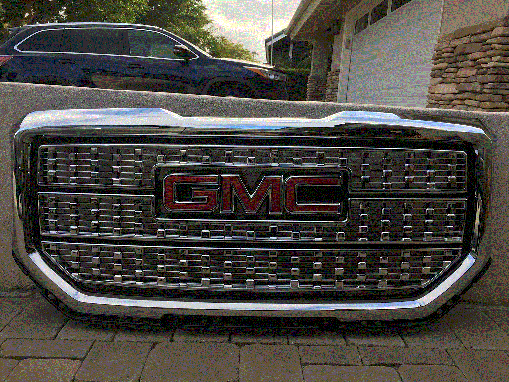

My stock Denali grille and chrome skid plate are now for sale.  They had 250 miles on them when I took them off.  Pristine condition.  No broken tabs, no broken anything.

Your conversion turned out great! I’ll definitely have to get a black skid plate piece for my denali, the chrome has to go! I’m also interested in purchasing your Denali grill if you still have it. The previous owner swapped the Denali grill for a billet grill that I’m not a fan of. I do like the Denali grill but would have to color match it to get rid of the chrome. Let me know if your is still available, thanks!
I'm selling my denali grill if you're interested.
