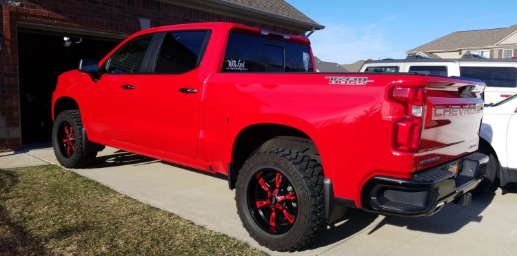

Do u have a side picture of the truck you can post?  It's hard to see from the angled pictures you orginally posted but maybe it's possible that they didnt install the Trailboss lift?  I cant tell honestly.  Here is a picture of my non leveled Trailboss for reference of how much distance there is between the tire and fender tops.
Do u have a side picture of the truck you can post?  It's hard to see from the angled pictures you orginally posted but maybe it's possible that they didnt install the Trailboss lift?  I cant tell honestly.  Here is a picture of my non lifted Trailboss for reference of how much distance there is between the tire and fender tops.
It’s hard to tell with the black, but there’s a lot of space in the rear wheel well. And on the front rear wheel it doesn’t come that close to the mud flap at all
It is hard to tell but I do see that your truck has a lot of rake, at least in this pic.  Mine doesnt have that much rake at all.  If you measure from floor to fender top, the back should be 1.5 inches higher than the front.
