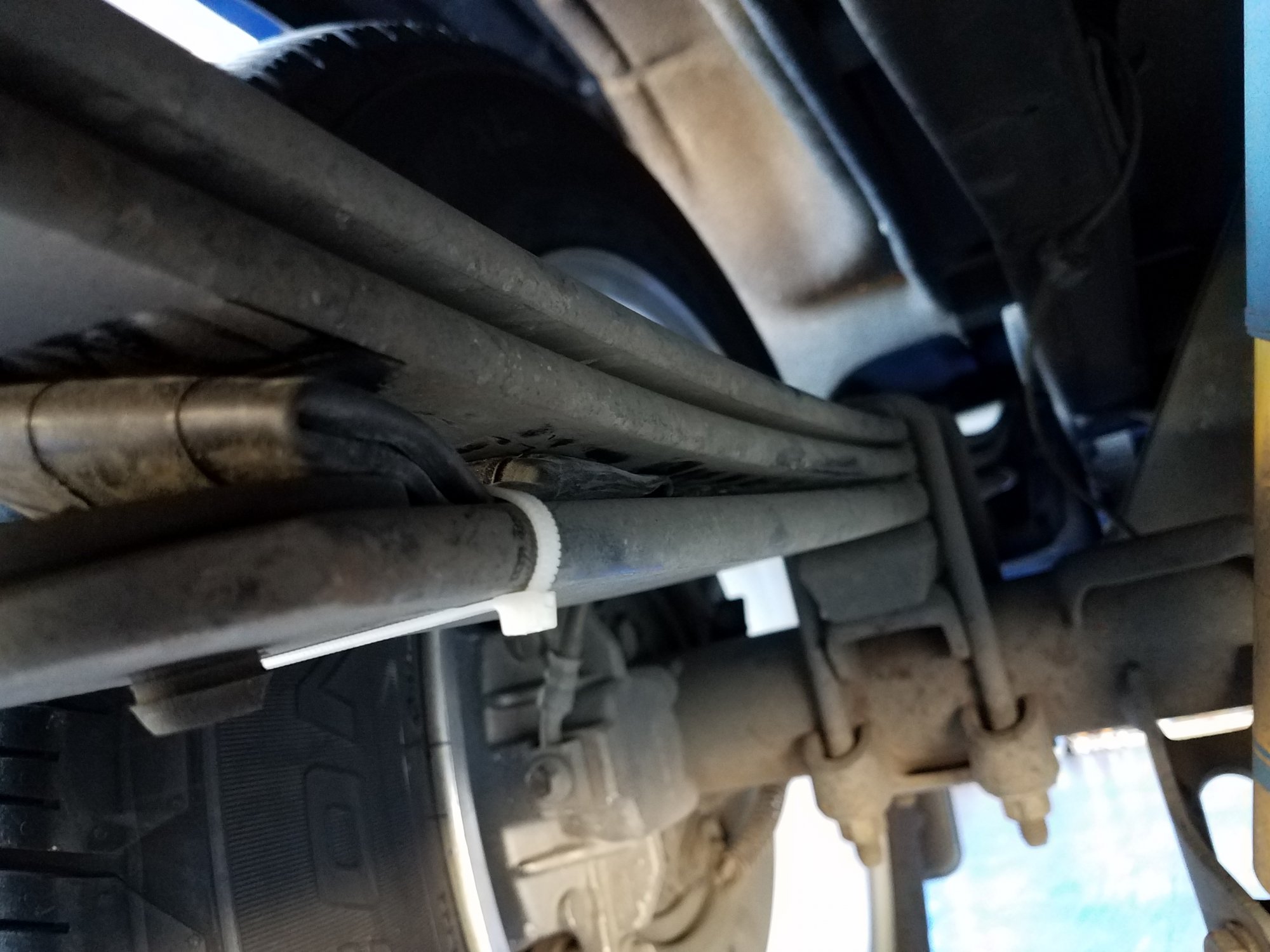

I had read about it here. I went to walmart and bought the biggest diameter and fattest tube size on the shelf. I cut the fill valve out. Then I cut the tube in half. I then cut those two halves in half again so I wound up with 4 pieces approximately the same length. I jacked the rear of my truck up by the frame in front of the wheel. Took the wheel off. for the half of the spring in front of the axle, I took one piece of tube and slid it in the gap between the bottom spring and slid it as far back as possible. There was enough tube left near the spring pads that I could fold it over and hold it in place with tywraps over the pad. I did this same procedure on the rear half of the axle. I did this on both sides of the truck. It seems to have quieted the ride for now. Seems like the tube was less than $10 so not much to lose and only took about 20 minutes to install. I'll try to get a picture tomorrow.
decent. so basically the tube is gonna buffer or eliminate any of the overload spring sqeek/clunk that happens. hows it holding up?

I also used rubber jar lid grip, cut into 2x2 square and placed in to where i Greased the leaf pads. I haven't had any problems in three weeks.
