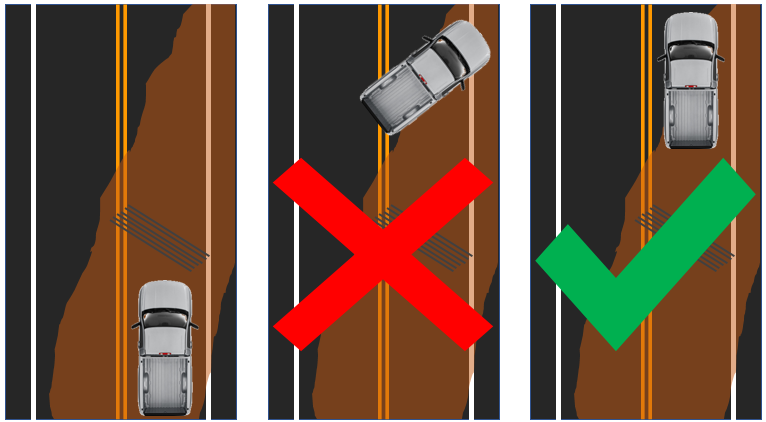

Which outcome do you prefer? Road is straight with dirt on top of it. Hint: the one in the middle is a potential liability issue. No braking, no accelerating, on a straight road. C'mon. Easy to answer this. For the record, I am not exaggerating here, it was off by 45 degrees after about five seconds on a straight road. I had to really swerve.

I don't even think it had a reason to hook up, could it still hook up based on the terrain? The rear end came around so fast even if the road was straight. It was mind-boggling and I could never imagine this happening to any 4x4, I was at 45 degrees, it wasn't a trivial issue, it's nothing to scoff at, it will even catch an experienced off roader off guard. It was not an exaggeration, it happened quickly and I was alert when it happened. If I wasn't, I could have killed somebody with that truck especially since a lot of the roads are not paved near the ranch.
