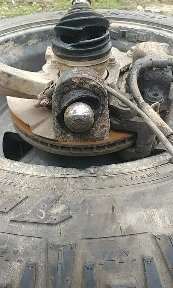

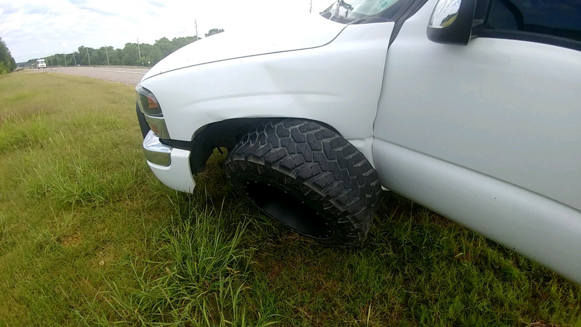

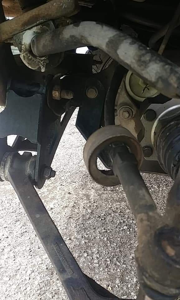

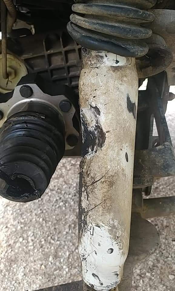

Ok so I had an issue with my truck. I had a lower ball joint fail and brake at 65 mph luckily the tire pinned to the finder keeping the truck suspension off the ground for the most part. I ripped the axel apart bent the inner tie rod, toasted the bearing, and pulled the upper ball joint out of socket. Now I have replaced everything ( upper and lower ball joints, inner and outer tie rods bearings hub and axles). Got it all finished today and the tires back on. Now I have a new issue and I am lost. My toe is way out. I am lost. I have the passanger side almost straight but the driver side is way out. The problem is I have no more adjustment left in the tie rod they are pulled all the way in. I don't know what to check or even where to go now. I need my truck back soon and now I am lost. Any help would be great

What about the lower? Judging by your picture, it looks like a lot of rearward force to the lower arm, and possibly the knuckle.
The lower is the one that snapped off I will look at it when I get home. One thing I did notice was the Pittman arm has alot of pay in it.
