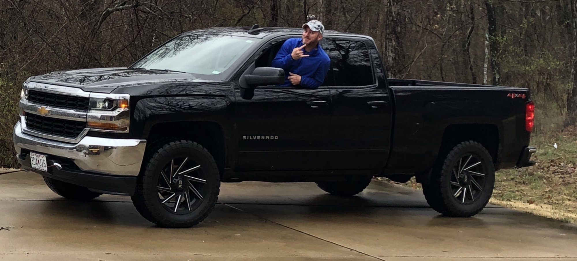

So I just bought a 2018 Chevy Silverado Double cab 1500 4x4 in February. Now the wife wants to buy a travel trailer...
Curious, what kinda weight you’d be comfortable with towing.
