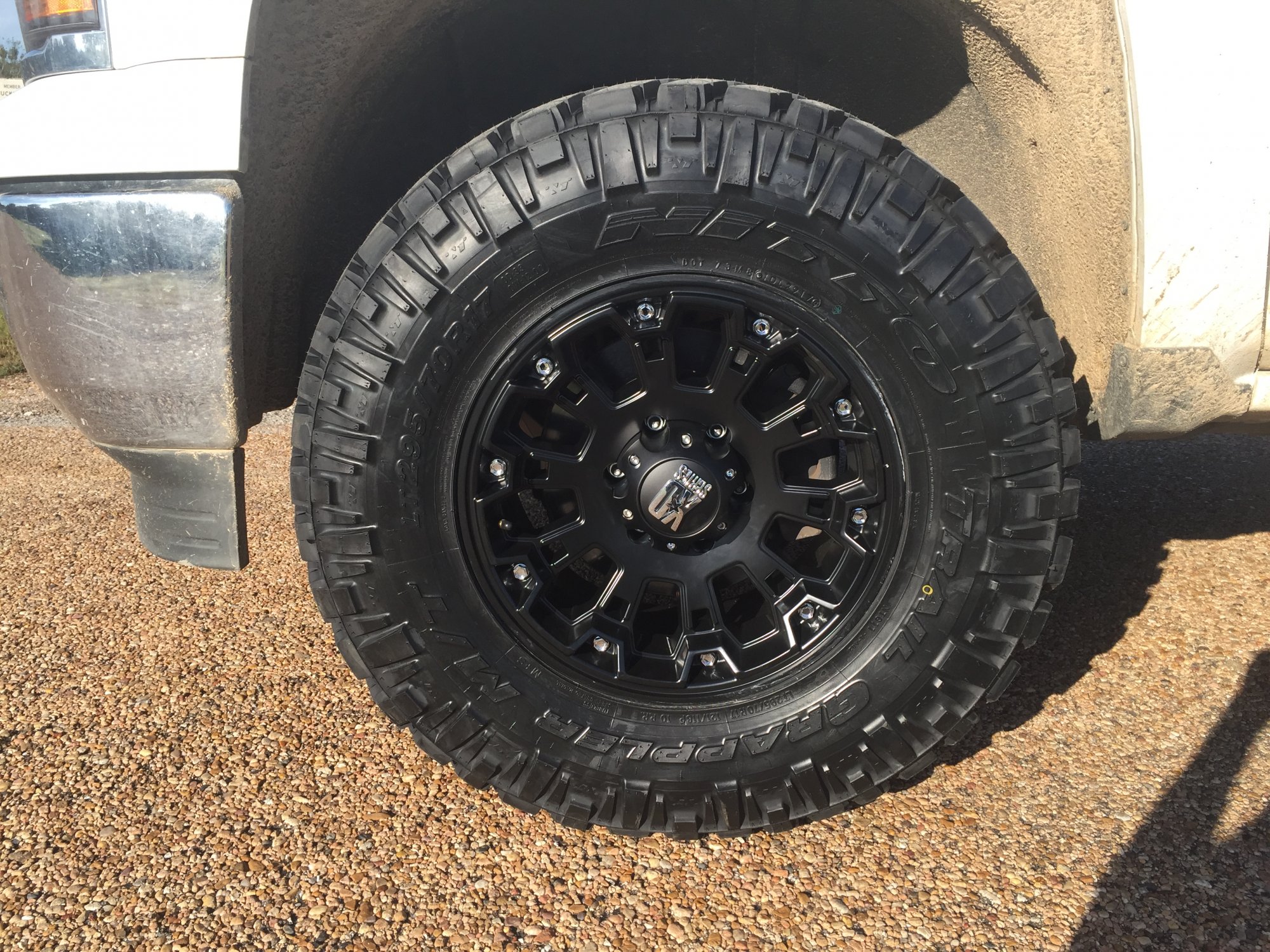

do you have another picture to that? The second picture is broken and I am very curious to see what it looks like
[IMG]
Does that work? Notice how the tire is almost stretched to fit.  The sidewall is no longer as concave as it should be.
