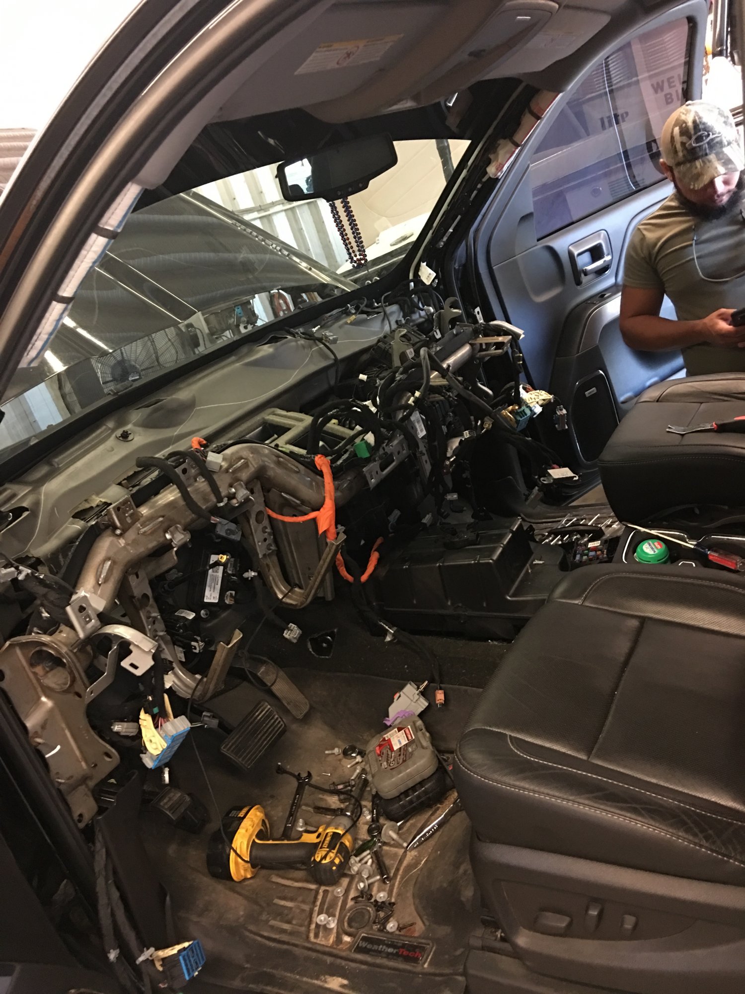

So I’m new to this site I have Used it for years for various information to random issues however I have encountered a issue I cant Seem to get resolved, I have A 2015 Silverado 2500hd w/ the duramax since I bought The truck I have Had mode door actuator issues it gets stuck in defrost quite frequently abt ever 10 months from having it “repaired” I bought It new it’s been in 4 times for warranty for the same issue the actuator has been changed 3 times and the mode actuator module once and now 6 months later I’m having the same issues. I have Decided to go into it myself being I’ve worked on several vehicles over the years top to bottom I’m not a master technician in he automotive department but I’m very familiar with everything. My main concern is has anyone else had this issues I dont Want to keep replacing actuators once a year it’s a pain to get to i currently have he entire dash out so I could Check the mode doors they seem to move freely without binding by me turning them through the cycles by hand without the actuator, could I just Be that unlucky with these actuators? Any help would be appreciated I appologize If I’ve overstepped an old post with a new one but I’ve had no luck finding much of anything on this issue with these model trucks
You are definitely not the only one with those issues. We have had 3 - 2015 2500 in our fleet that have had issues with these. I am pretty sure my 2015 also has issues but seeing pictures like this makes me just want to leave it as is haha.
Well I didn’t mean to post the picture as negativity, I just Wanted make it aware that this is a big deal. however what I’m doing isn’t necessary to replace just actuators I decided To tear it down with hope to find potential mechanical issues with the doors or linkages, so far the only thing I’ve found that I feel Is a potential lead is the plug itself on the actuator I dont Feel like the pins are snug inside the connectors causing possible feedback interference from a poor connection, I will start reassembling it tomorrow.
