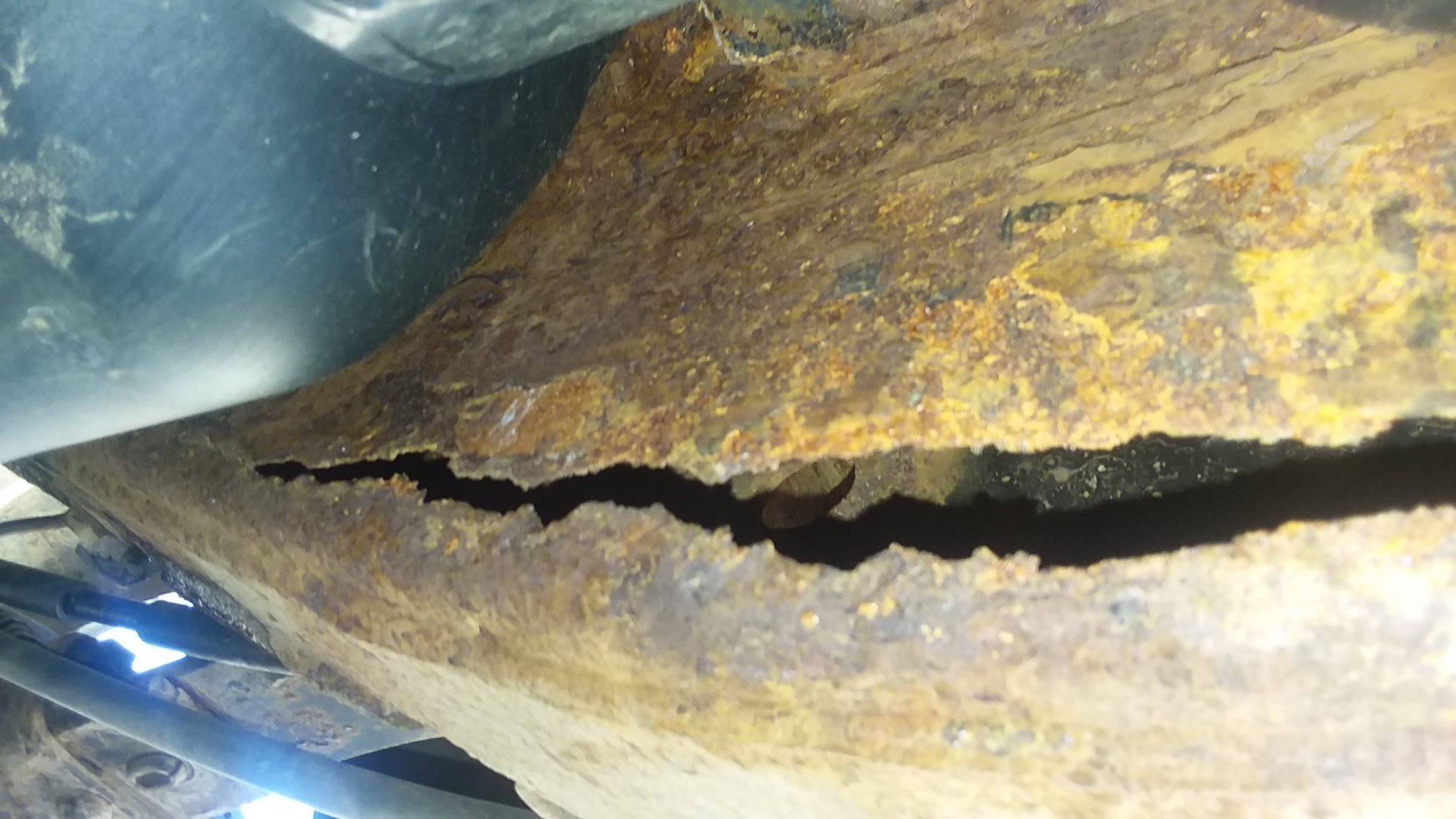

I removed bed,2 reasons,1,proper job,plus standing up,lol,2,my gas tank straps looked so poor,I figured,get it nice for next fuel pump change,I previously tried to change straps,I broke the weld on frame nut,it spun, couldn't get at it
So you didn't reply with"how poor were they",so,they were so poor,when I drove thru a coin drop,they gave me money
