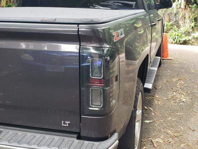

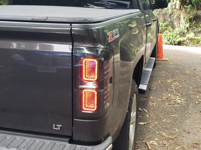

I've been running the Raxioms for a couple of weeks now.  I believe them to be the same as the Morimoto's, without the 10-year warranty (and maybe crappier built-in resistors?).  The housings are made by the same folks, as you can tell by the DOT stamping showing the true manufacturer name.
They're nice and bright, but the reverse LED paints a strange pattern of light in your rear view camera as it tries to "project" the LED through a small lens.  I've also run into them hyperflashing.  Both sides have hyperflashed/bulb out warning on me, and the fix is better resistors wired into the harness.  So far I've had a decent customer service experience with the AT guys.
I'm probably going to keep running them.  I blacked out my 3rd brake light with vvivid vinyl clear smoke tint wrap and swapped the bulbs with LEDs to match.  Sorry, the truck is filthy as we had been expecting some bad weather that never materialized.
