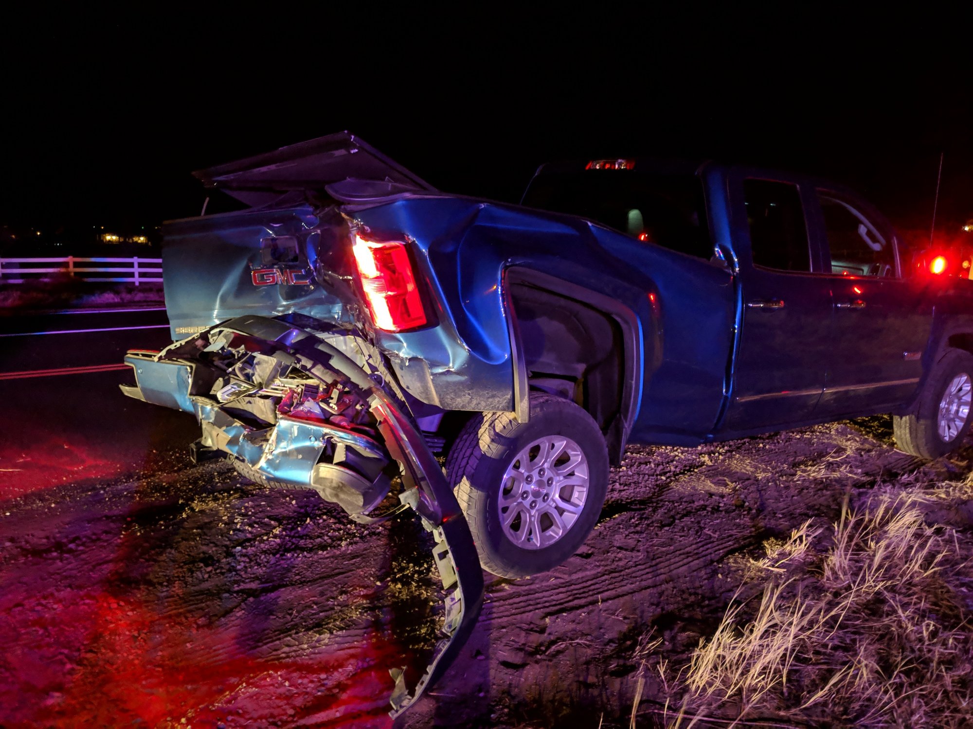

I have to agree, even the smallest, lightest car at 80 would do more than that.
This is what mine looked like when hit at about 60.

There is no freaking way that is what she’s calling 80mph.
That’s probably about the amount damage that would happen if prime lawrence taylor was trying to tackle you truck.

In every GM vehicle i have owned, airbags do not deploy in a rear end collision. Your head and back hit the seat back and headrest first, then the seat belt tensioner pulls in the slack, once the body forward motion and momentum starts again the seatbelt stops the forward movement. In this case you typically end up with a case of whiplash to the passengers.
Just because the vehicle hit the vehicle in front doesnt deploy the airbags either. Airbag deployment from a front in collision requires a certain forward speed to be met and for the front airbag inertia sensor to trip the airbag deployment.
Even though the OP was a standstill and was hit at 80mph and push forward into the vehicle in front of him that doesnt mean his vehicle reached the acceleration and speed needed for the front airbags to deploy. The deployment speed was changed years ago when a lady sued a vehicle manufacture when she hit a curb head on at 5mph and the front airbags deployed, her son or grandson was killed from the front airbag deployment. That is when the manufactures changes the airbag deployment speed to vary depending on the speed of the vehicle, adding to where the airbags wont deploy if the front seat passenger cant trip the seat weight sensor, and changed how fast the vehicle had to be moving for forward for the front airbags to deploy.
Unless some new changes have been made, there are no sensors in the rear of a vehicle to tell the airbag to deploy. Your back and neck will hurt regardless if the airbag had deployed or not. As previously mentioned, airbag deployment when the front of the vehicle has struck something depends on a number of factors that the sensors and computers calculate. You likely did not meet the parameters for deployment.
Looking at the pictures of your accident, I would say that you were hit at the most 30mph and that comes from pics shown by EMS when they transport patients to the ER to be check out. I am curious as to why your engine is shot as I didn't see a picture of the front end.
