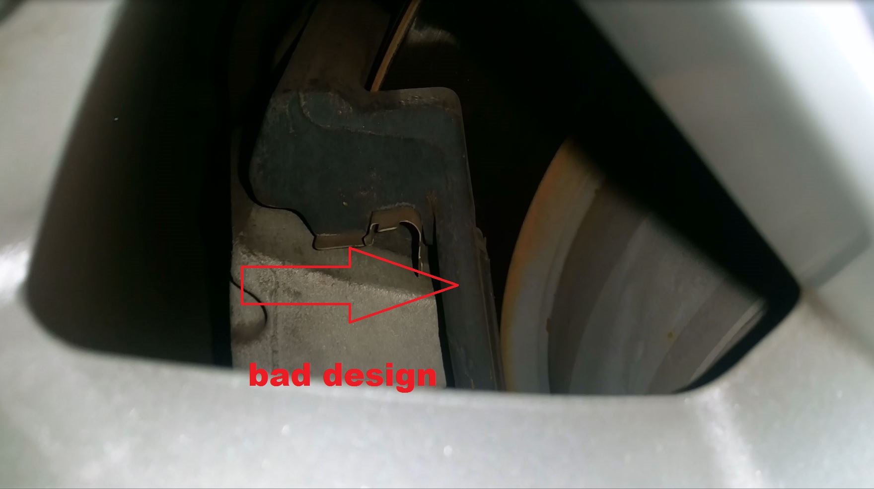

  who the hell makes rectangle brakes pads    it's like trying to fit a square  peg in a round hole  TOTAL FAIL in design
as you can see in the photo  there is very little surface area touching the rotors
