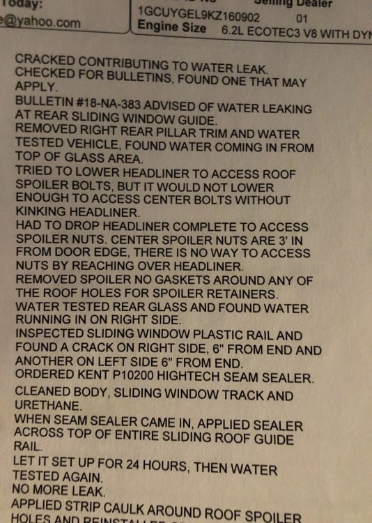

Take it for what it is, but my dealer had to completely drop the headliner to access the spoiler bolts. It looks like in order to do that, they had to remove all of the trim up to and including the A-pillar. As well as the dome lights, visors and rear view mirror. I know this because they left marks/ evidence of removing all of this stuff.
The other thing is...if you take it off or disturb it, you might be inviting a water leak.
