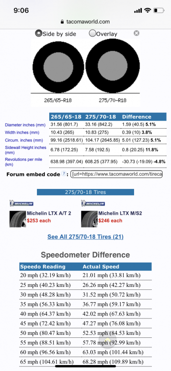

 you increased the height and tire size
that means you increased the "drag" on it
 if you want better MPG get a Prius .. or volt
17 to 14.5 = 2.5MPG  which sounds about right     3 or 4  is incorrect  math
