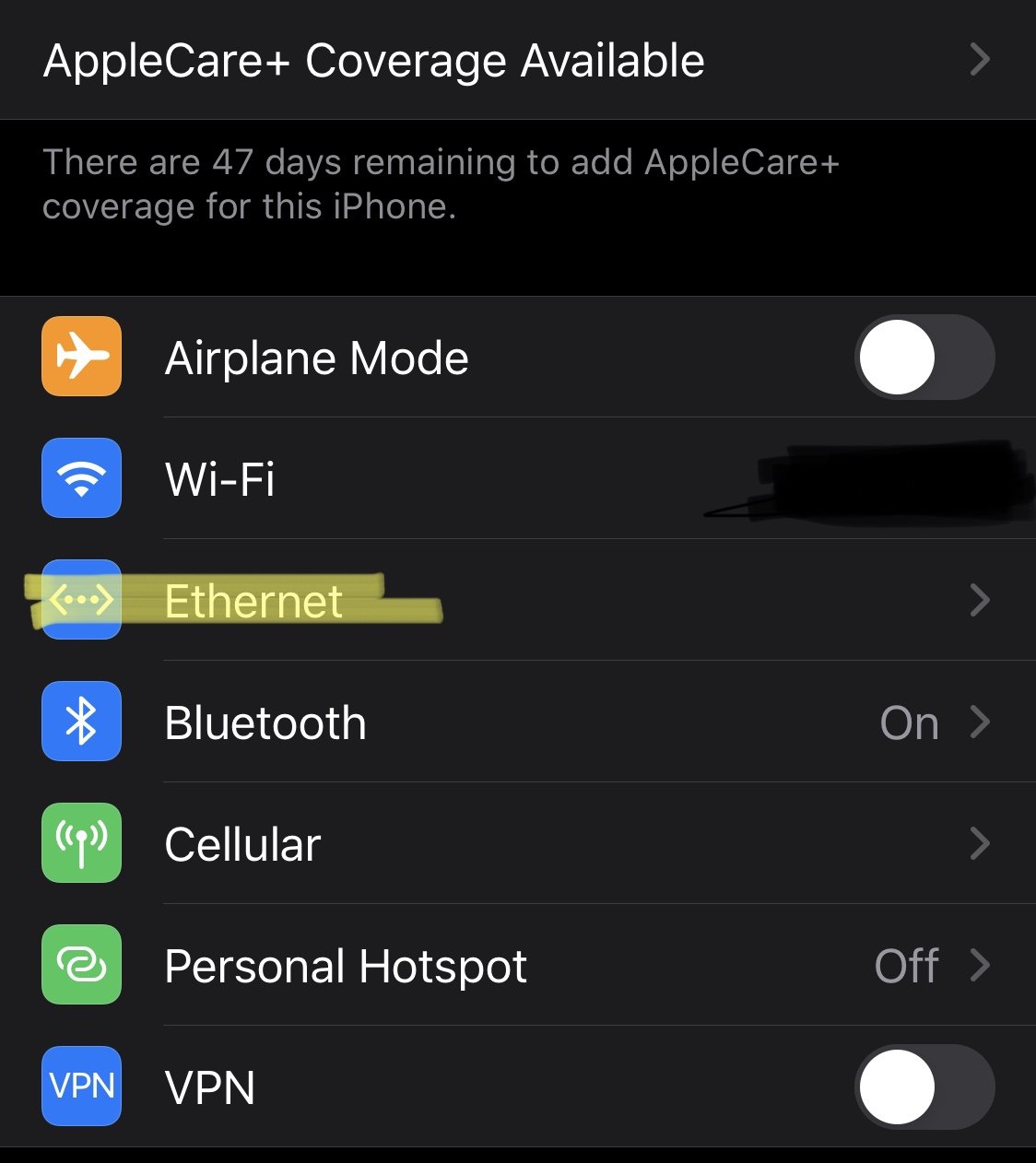

something interesting popped up the next time, see attached. Ethernet option popped up in connections on the iPhone.
it almost seems like the iPhone is Confused or not recognizing the device It’s connecting to is a CarPlay device.

I also see the Ethernet option pop up in setting sometimes. Sometimes it works. Sometimes it doesn’t. I’ve tried all the resetting. This past week it seems to work better if I plug in my phone before starting the truck but not 100% of the time.

I really feel like it is something related to Chevy and the new iPhones. My wife is having the same issues. She called me yesterday saying she had no internet on her phone. I told her to check the settings and sure enough, Ethernet was listed so it was thinking it was connected to Ethernet but obviously no internet connection.
