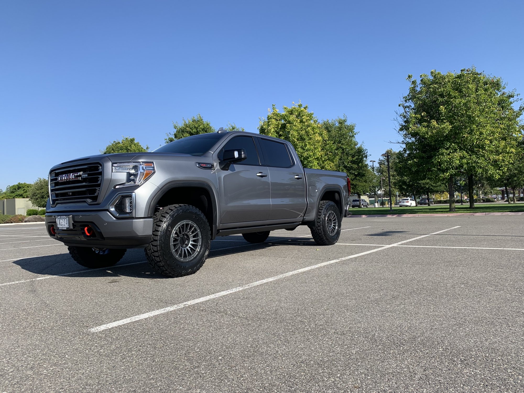

B9E8C912-AEF9-489D-96CD-1B0282520125.thumb.jpeg.f5e7ae7cf58c8845ad3f99bccc7b3828.jpegI installed a CST coil over with Resi set up (3.5”) in the front and it feels like it tops out when going over bumps. Anyone have this issue?
8 hours ago, KillerOfMillers said:
is that ball joint set into the spindle all the way?  Looks like quite a bit of the
pin is still showing, is that correct fitment?
Good catch on that, looks like it needs a lot of tightening.
I had that issue on my 14'  after fox coilovers and Cognito Upper control arms.  It was easy to see with the coilover removed that the tie rods would actually reach their limit for range of motion.  I dropped the lift down .5" and that helped out.  I am looking to do a similar setup to my 19' SLT 6.2 NHT.  overall how happy are you with the CST setup?
Good looking truck. I had the same coilover and upper control arms on mine. I have a 2.7 though and it had the same issues. I attributed it to the spring rate being too heavy and sent it back. If you call them they will work with you.
Yes that's correct. It's a tapered uniball that's designed like that on purpose.
