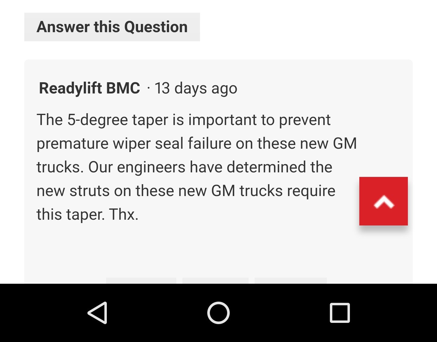

I have been shopping around and come across the Readylift and Motofab lower strut kits. Biggest difference I see is the Readylift having the 5 degree taper and the price difference ($129 for the Readylift and $36 for the Motofab). Has anyone had experience with both or either? I am open to other suggestions as well. I had Bilstein 5100 on my old Ram and loved them but wanted to go this route for right now.
I don't know, but I'm interested to know whether there is an advantage to the stated 5-degree taper of the Readylift option, or whether it matters at all.
My thoughts exactly. I am trying to justify if that is worth the extra money.
I went with the ready lift because it says "Not for 2014-2018 trucks." All the others use the same spacer for everything from 2007-2020.

My Ready Lift should be here Monday. The taper makes sense to me and it looked, overall, like a nicer piece of hardware.
