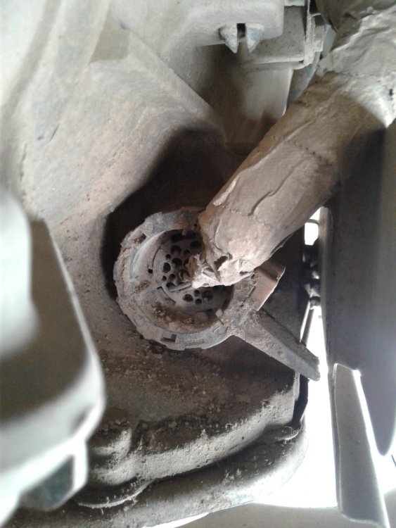

Is cover missing in this tranmission connection?
While under the Silverado the other day, I noticed this connection that goes into the transmission on the right/drivers side.   Just doesn't look right, looks like a cover is missing?  Thought about covering somehow or filling with some of that putty I use to seal around A/C tubing as it goes into the house, but have left alone for now.  Maybe this is suppose to be left open to elements?   Not the way I would do an electrical connection, but I am an old fart and not use to new ways.

Its food ugly but good. There is a outer ring made of plastice that roll locks that harness in and the pins like everything are weather pack so no worries.
I think the outer ring that 1SLOW1500 mention is that piece with what looks like a latch at about the 4 o'clock position.   Sounds like the open pin holes as well as uses pins are weather packed so water and trash don't get in causing problems.  I was going to stick plastic wrap or similar in first (didn't want to fill holes up with putty) and then pack with plumbers putty or Ideal duct seal putty.  Now I will leave alone.
