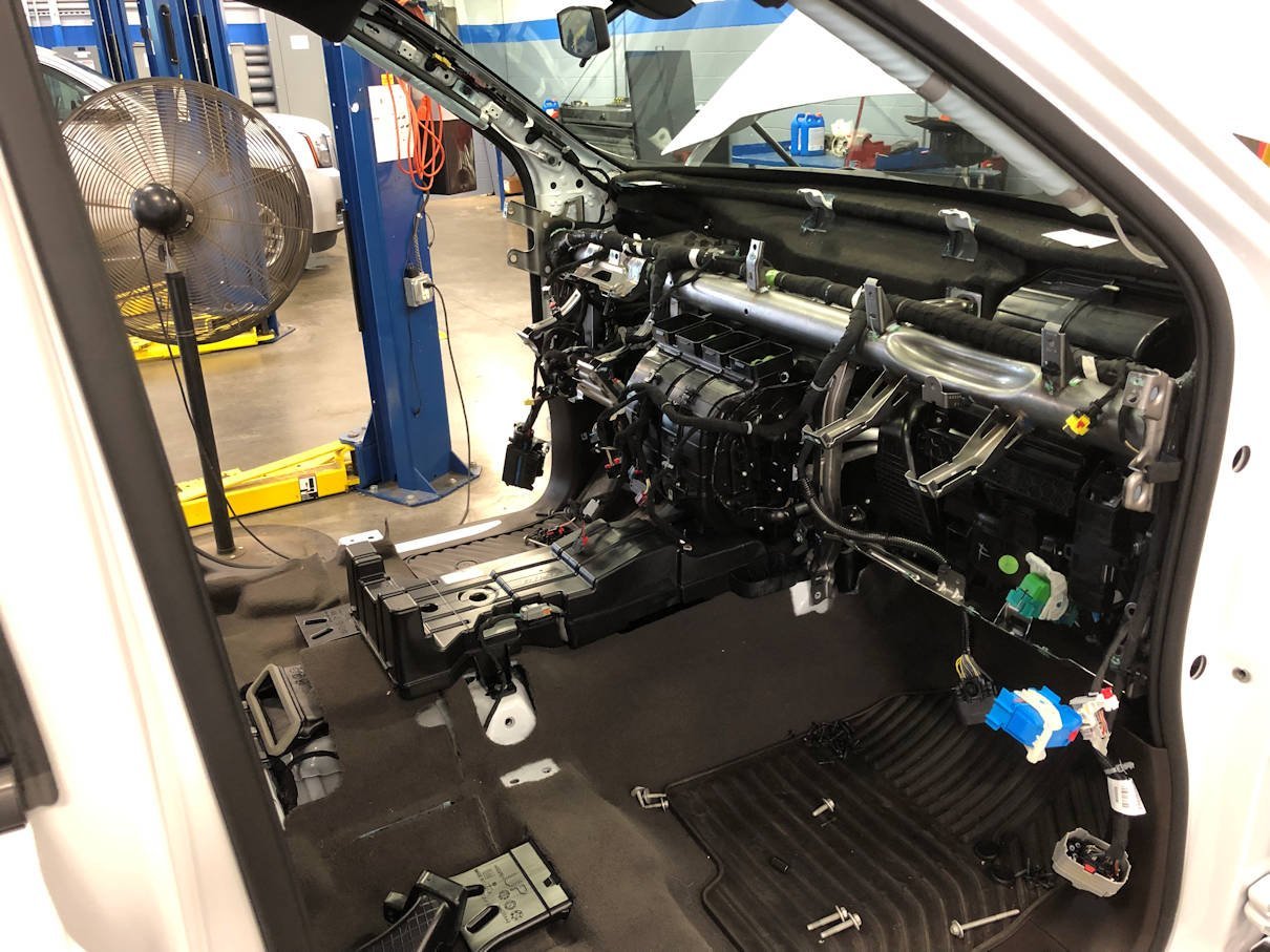

Above pic is from a member here who had a leaking evaporator core.  Not a pretty site when the dash comes out...
Luckily taking apart the area around the climate controls isn't anywhere near that laborious.
