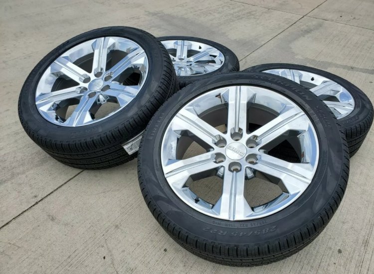

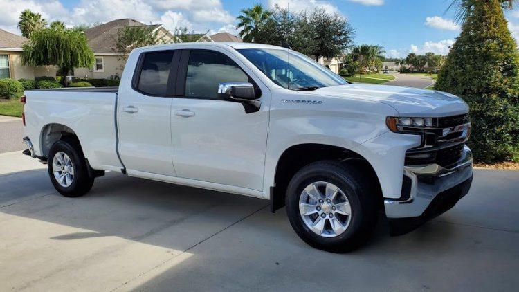

Pick up a new Silverado yesterday and Im looking for some take off 22in OEM GM wheels. Seems with a new brakes a lot of these older model wheels won't fit. Search around for a few hours some say some do some don't I don't know. What fits? I like these but I'm not sure if they'll clear the rotor.

I have these wheels. They will not fit over the brake caliper. Looking for a spacer or adaptor so I can use them.

Those will not fit.  I went with OE Creations wheels distributed by Wheel Pros.  They have the new GM style '19 wheels.  I've had many sets of 22" wheels including OEM and aftermarket. I can tell you these wheels are top quality with a beautiful finish and you won't find nicer.  These are real chrome plated and not PVD chrome.  They balanced out perfect with very little weight.  I went with the chrome "22 PR196.  Here's a link to the 22" wheels that will fit the '19.
https://www.wheelpros.com/wheels/oe-creations/?wheel-diameter=22

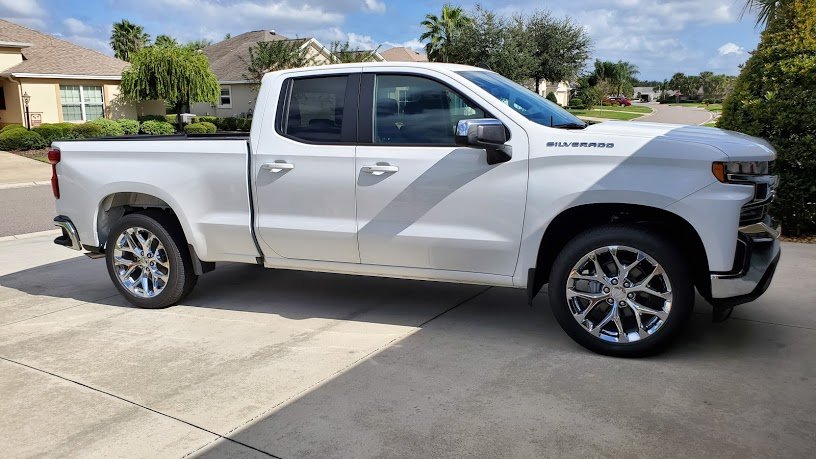

I tried to get those CK157 wheels on my new truck and they wouldn't clear with a 3/8" spacer. I didn't want to go any bigger with the spacers because this truck will be dropped 2/4 or 3/5  so I picked up a set of 22" new body style OEM Snowflakes. What a dramatic difference wheels and tires make. Wow.
Anyway, I'm listing my take off wheels and tires on Craigslist and I'm not sure what years they will fit. 1999-2018? 2007-2018? A little help here please :)
And of course here are the before and after shots......

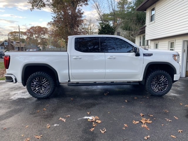

Thank you. I have the RC leveling kit and the wheels and tires are OE Performance Replica and tires are 285/55r22 Nitto Trail Grappler
Is that the 2 in. RC level or the 3.5? Also, any rub?
